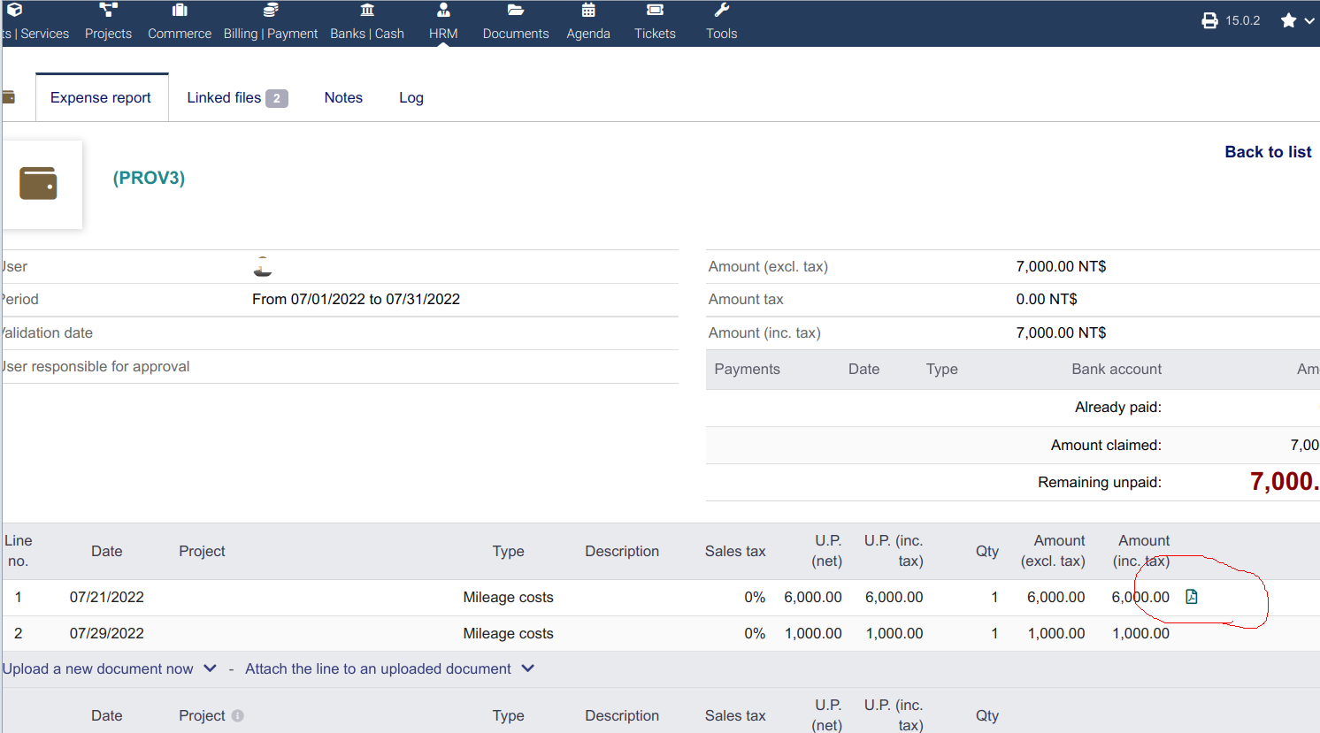

Can't see preview button in expense report line
Hi
I have upgraded to 15.0.3 from 14.0.3 .
And i notice the expense report line should have a preview button when i attach a pdf file with it .
But i can’t find it .
Are there anyone know how do i fix it ?

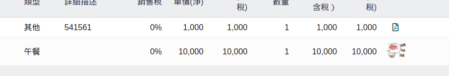

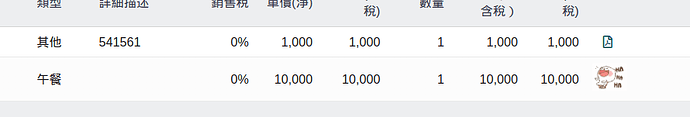

As my testing , the preview function is working for picture kinds file , not working for pdf .
