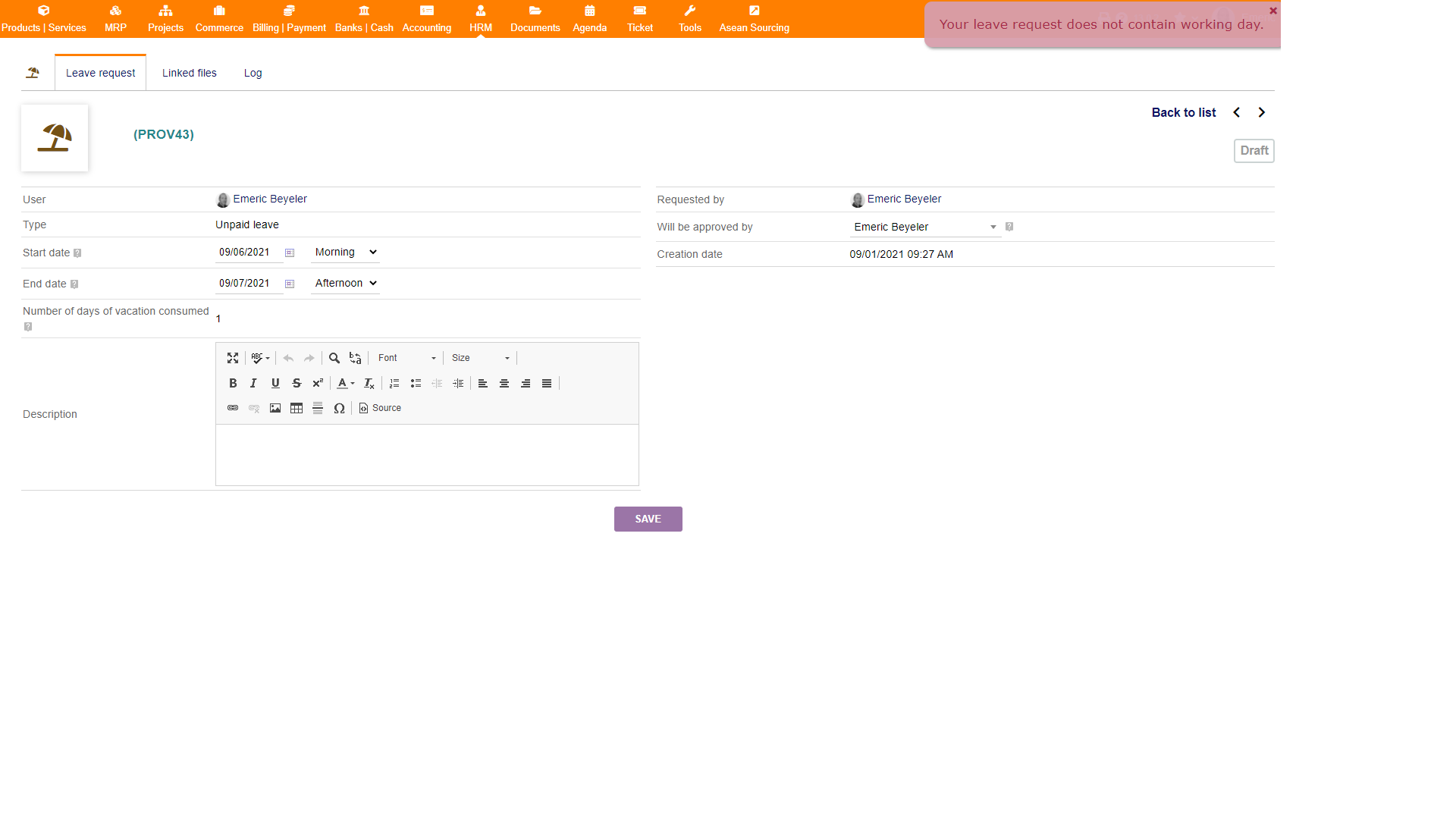

I am using Dolibarr 13.0.2 and i have a problem when adding a leave request on Mondays. This error message appears:
Your leave request does not contain working day.
Working days are set on 1-5 while first day of the calendar is set on Monday.

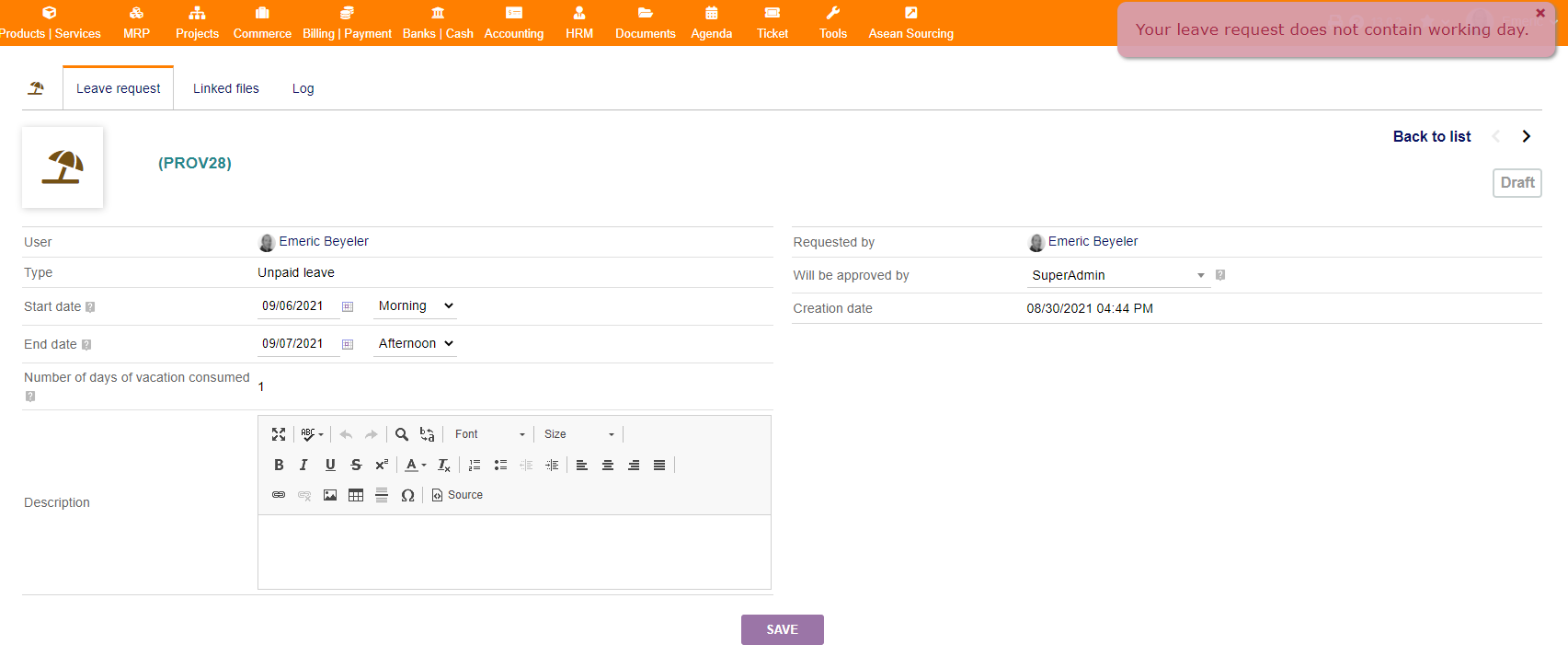

Well, indeed this could be the reason why but actually i am facing the same issue for all Mondays of the year.
On the other hand, I noticed that Saturday is counted as an open day, while my working days setting is set to 1-5 while the first day of the week is set to Monday:
