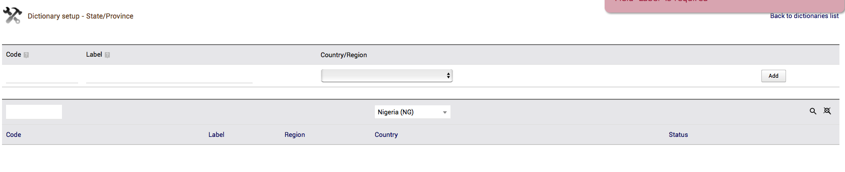

Hello everyone,
Thanks for the wonderful job Dolibarr is doing. It has a very promising future.
Quick one, i’ve just seamlessly installed Dolibarr (7.0.1) but finding it extremely difficult to add content to dictionaries. For example, I tried to add, states and provinces to NG under Setup->Dictionaries setup->State/Province but NG is not listed in the Country/Region above dropdown menu.
Please how do I go about solving this?
Thanks in advance
Hi MosDef. Go to Setup->Dictionaries setup->Countries and check if Nigeria is enabled. If it is then go to Setup->Dictionaries setup->Regions to check if you have created regions for Nigeria if not then create them or al least one e.g.
Code 701
Label Nigeria
Country NG - Nigeria
make sure the Region is enabled and you should be able to create State/Province.

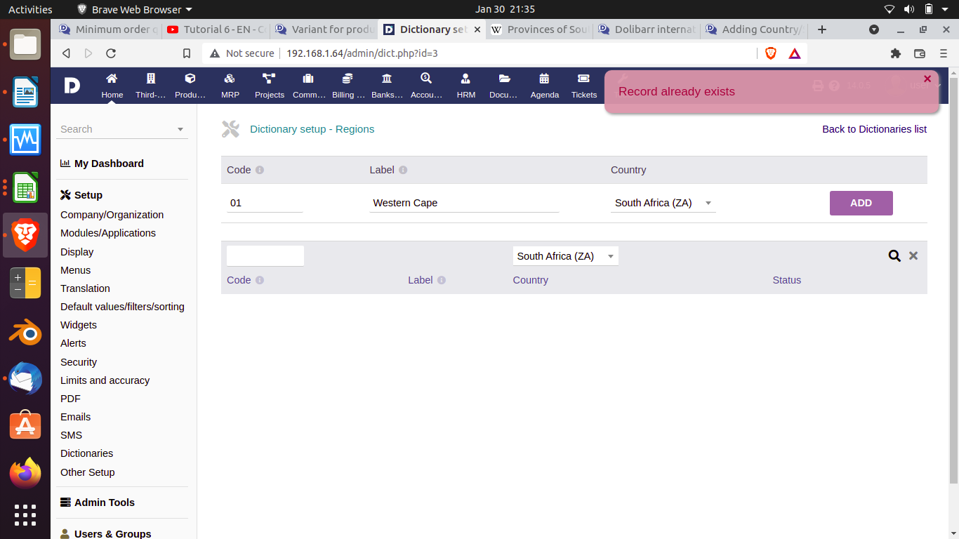

Thanks very much for the post. I am trying to add provinces for South Africa but its is saying the record exist. But I know the Provinces are not there. Please assist
Just guessing, but probaly the value you used for “code” (01) has already been taken.
