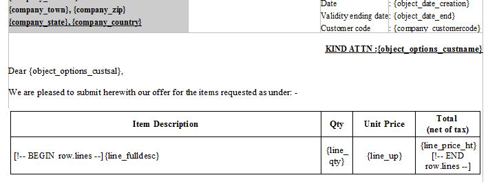

you also need to just place the tag appropriately on your template so it comes out as desired. I am using the same fopr my proposals.
For you reference I have attached a snapshot of my ODT template.
