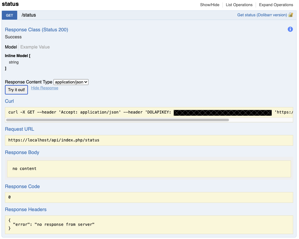

API explorer stopped working, it tries to connect to httpS://localhost

Anyway, this post is about something else, namely that today the API Explorer is not working, because it tries to connect to httpS://localhost which is not responding when you are running inside Dolibarrs official docker image

In front of my Dolibarr container I have an nginx that does reverse proxy for dolibarr and other containers. Nginx is who encrypts with HTTPS towards the internet, where as the connection between nginx and dolibarr is plain http and runs over a virtual network card.
My other containers can access the API, and if I am inside my dolibarr container and I use curl I get these results.
root@dolipod:/var/www/html# curl http://localhost/api/index.php/status ; echo ""
{"error":{"code":401,"message":"Unauthorized: Failed to login to API. No parameter 'HTTP_DOLAPIKEY' on HTTP header (and no parameter DOLAPIKEY in URL)."}}
root@dolipod:/var/www/html# curl https://localhost/api/index.php/status ; echo ""
curl: (7) Failed to connect to localhost port 443: Connection refused
If I go into About Dolibarr page under Home, Admin Tools, About Dolibarr then I see this different value for the URL Root
URL Root	dolibarr_main_url_root	http://localhost/dolibarr (currently overwritten by autodetected value: https://****.*****.*****/dolibarr)
Why does it think it is http://localhost/dolibarr when I have defined it as http://localhost/ ?
And is it because it is autodetected as httpS:// … that the API explorer also uses httpS on localhost?
Why does it keep thinking that the folder is /dolibarr/? I configured it as /

Changing conf.php did seem to make it stick - but it still uses httpS for the API - why?
