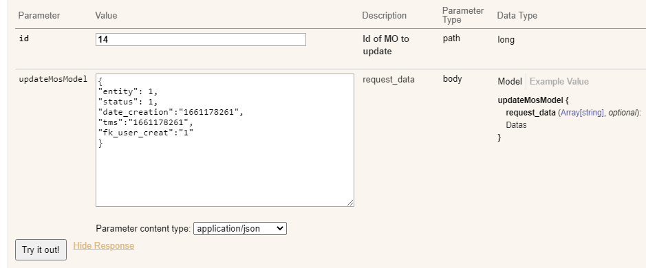

Hello Guys i have an issue with MO API, i have managed to create MO (using POST call), now im trying to validate the created MO im getting Error 500 (Internal server Error:BadStatus) below are my Request and Response.
---------Request-----------
“entity”: 1,
“status”: 1,
“date_creation”:“1661178261”,
“tms”:“1661178261”,
“fk_user_creat”:“1”
--------Response--------

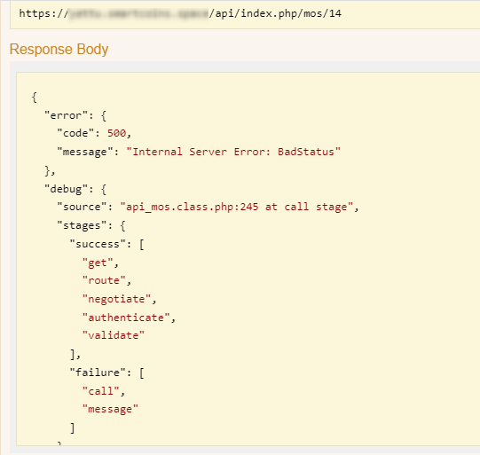

“error”: {
“code”: 500,
“message”: “Internal Server Error: BadStatus”
“debug”: {
“source”: “api_mos.class.php:245 at call stage”,
“stages”: {
“success”: [
“get”,
“route”,
“negotiate”,
“authenticate”,
“validate”
“failure”: [
“call”,
“message”

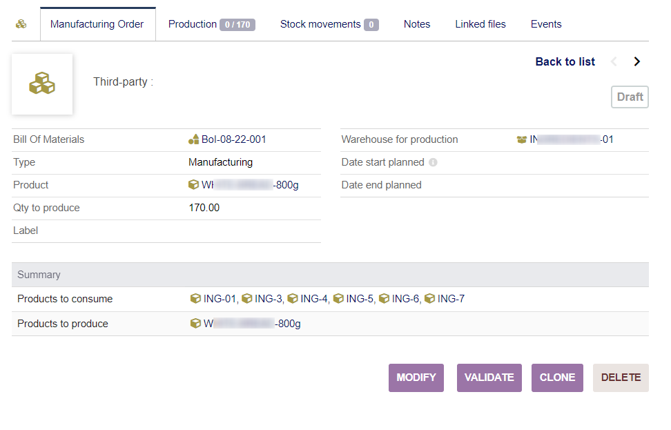

Now here the issue is i have created the draft MO with lines already, using the available post API though it seemed to have few issues. so i only need to validate and consume products…
User permissions are also OK, this user is a super admin, and i have enabled all the rights.
also even if i put validation date on the PUT API i’m still getting the same error.
