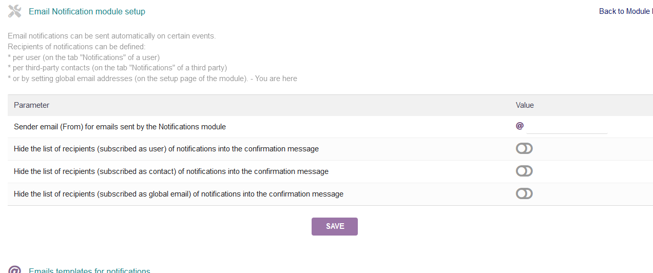

Somehow, the “from=” gets empty here and it seems this is the reason it fails. Sending test emails and sending invoices (or anything, really) with email from within Dolibarr works fine, but the automatic notifications have all stopped working.

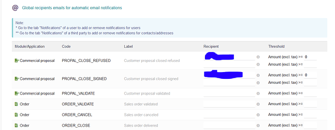

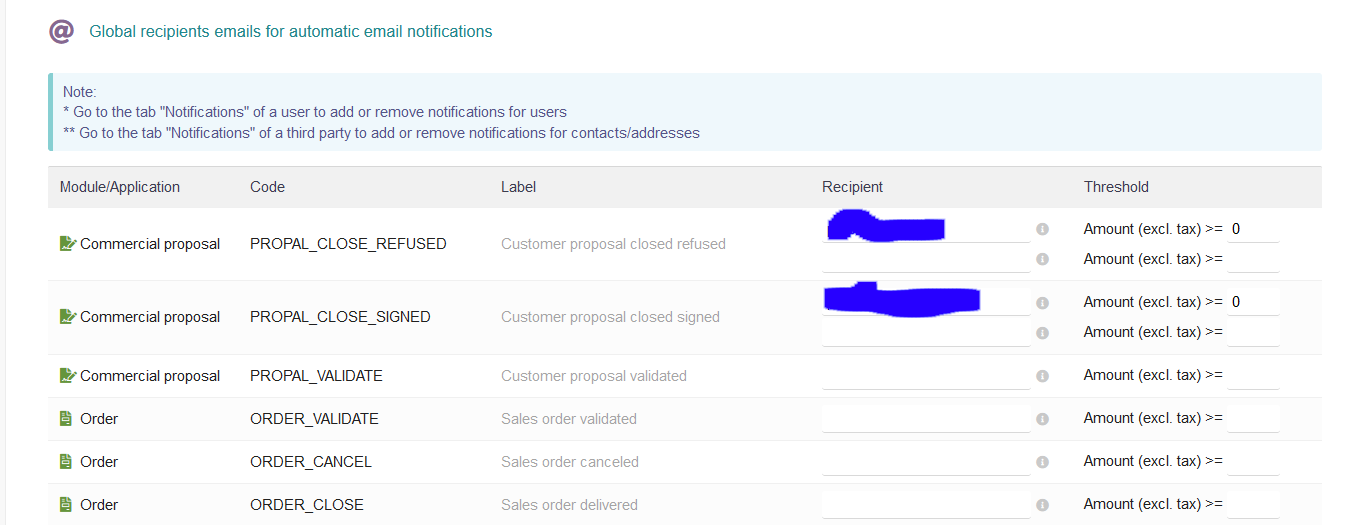

which notification triggers do you have?
I use proposal validated, order validated and invoice paid - I run v20.0.2 and have not experienced issues
V20.0.2. I use the following triggers:
I found the error. After the upgrade, the “Sender email (From) for emails sent by the Notifications module” field was empty. After refilling it, notification works again.
