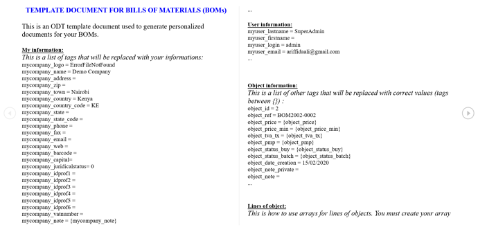

In MRP module only the BOM has an option for generating ODT but not PDF. When I open the ODT it is displaying like this:
I am using Dolibarr version 13.03 on a shared webhost.
How do I display the actual BOM? What about the MO, it does not have any generated document?
The question is how do I print BOMs or MOs?
Hi
I think you will need to make a odt template what you want .
That file you download is just a template .
