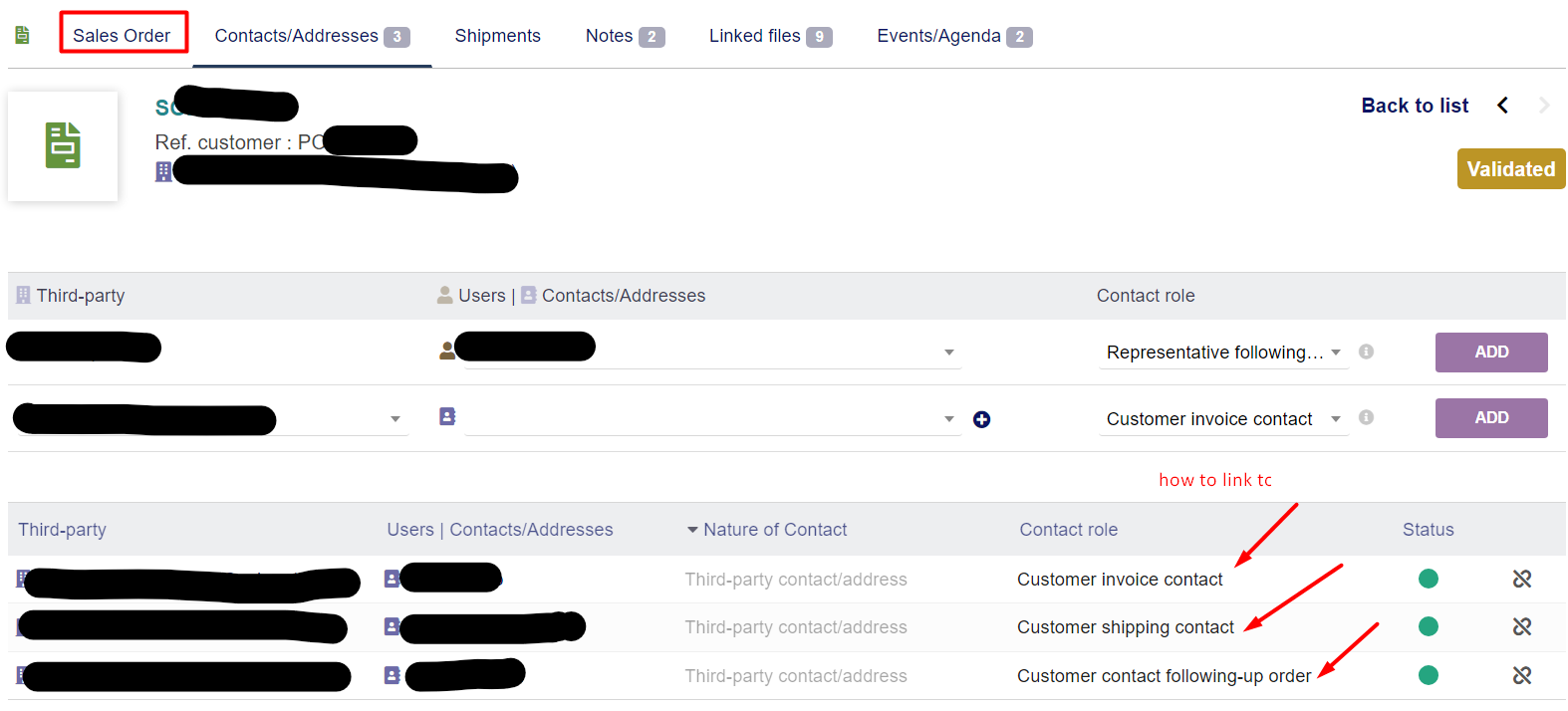

It appears that Dolibarr does not allow me to print “Bill To” and “Deliver To” (alternate addresses) on my Sales Orders. I have tried setting of ODT templates to add this type of information, but I don’t have enough background to make the necessary changes.
First approach: Is there any way to link the ODT ‘tag’ for Sales Order “Customer invoice contact” or “Customer shipping contact” or “Customer contact following-up order”?

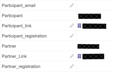

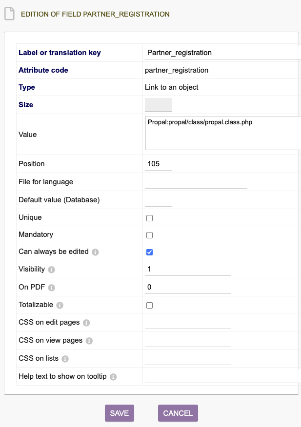

I have 2 fields on my proposal, one links to another thirdparty and the other links to proposal on that other thirdparty.
I use it for a dance class registration system, where the other thirdparty is their dance partner and the proposal link is to the dance partners registration. (the last linke I haven’t coded yet, just prepared.

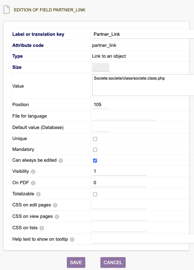

You need to create the link using a Value like this_
Societe:societe/class/societe.class.php
So you wanted it for a Contact, I think this is what you want to link to Contact:contact/class/contact.class.php
you can of course give it a Label like “Delivery Contact” or “Delivery Address”.
For me it shows up on a Proposal like the smallest picture below
links_on_proposals
I don’t 100% know what you mean with “pull up the Address” but if I click the link inside Dolibarr I’ll be taken to the other Thirdparty or Proposal. So surely clicking a link for you could take you to a Contact.

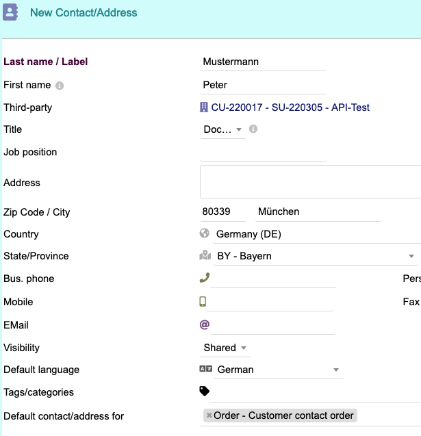

I would solve this as follows:

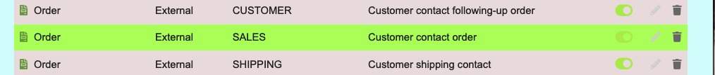

  • Add one or more contact types under “Dictionary setup - Contact/Address types”.
  • Possibly also an third party extra field (checkbox/combolist/…) for the selection of the contact (checkbox: checked = use contact address, not checked = use company address)
  • Store the contact with the new contact type under the third party contacts.
  • Create a new function in the ODT module with a corresponding database query for the contact with this contact type and store the result in the tags “object_delivery_contact” and/or “object_delivery_address”
  • Then use these tags in your odt template
