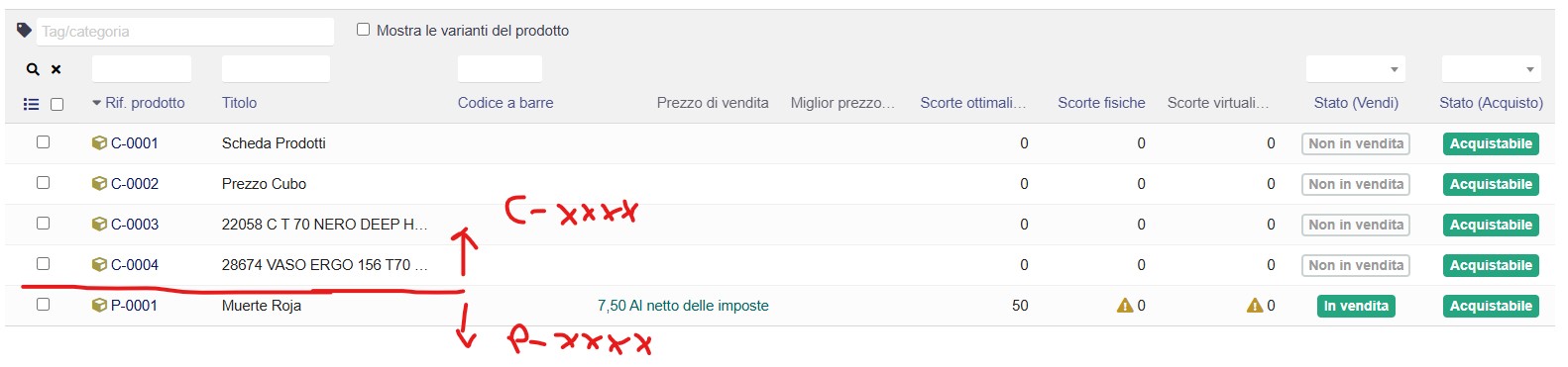

I wanted to know if anyone uses coding rules for products. I would like to be able to create a coding structure based on the product class, I’m attaching an example:
Raw material – MP{XXXX} ONIONS, PUMPKINS,
• MP0001
• MP0002
• MP0003
• MP0004
Purchase components – AC{XXXX} CAPS, GLASS JAR, LABELS
• AC0001
• AC0002
• AC0003
• AC0004
Finished product– PF{XXXX} JAM, JUICES ETC
• PF0001
• PF0001
• PF0001
• PF0001
Hello, what is the ultimate goal for wanting to use different “numbering series” for your products based on their category for the product references in Dolibarr? I mean, what would it bring to you?

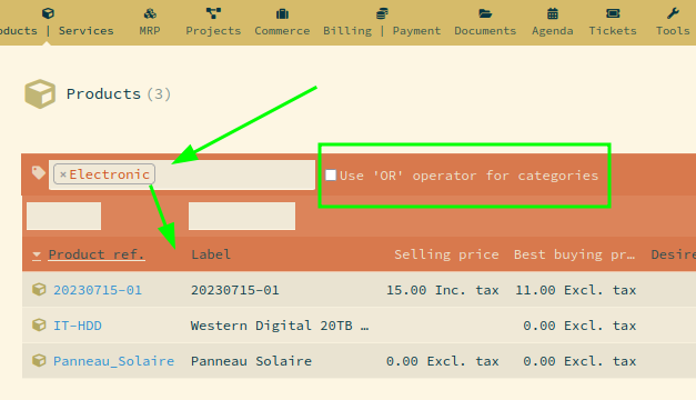

From the image you shared, I assume you are interested in being able to differentiate products by category in the product listings. If that’s the case, I think the following might help:
  • If you assign product tags for each category, you will be able to easily filter products by category:
  • The “bad news” is that I can’t find a way to display the tag in the listing, so that, as shown in your image, it would be possible to differentiate products by category in a listing with all products. It’s strange that this doesn’t exist. Maybe I missed something and I’m not seeing it.
In summary, wouldn’t managing your products with CATEGORY TAGS be sufficient for your needs?
Greetings.

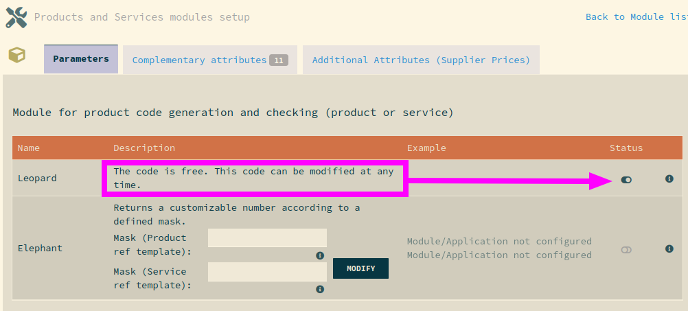

You can change the automatically assigned reference

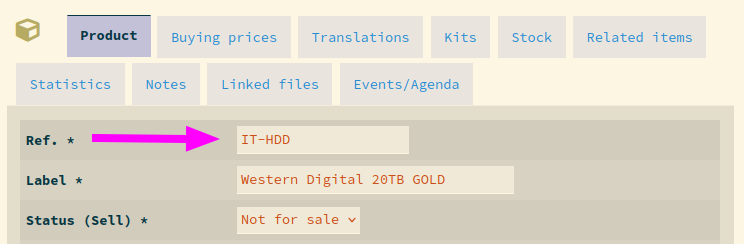

That said, are you aware that in the settings area of the PRODUCTS module, there’s an option (a switch) to enable the MODE Leopard to let you generate mannually the references for the PRODUCTS?
This means you can write the reference for new products, something like “C-002” with “R-002” whenever needed depending on the criteria you need. :blush:
I apologize for not remembering this yesterday when I suggested adding prefixes like “C-” and “R-” to product labels. It’s not actually necessary!

yes I had seen this possibility, and reasoning with u I convinced myself that I will use the leopard module. in this way there aren’t rules and I can write what I want.
