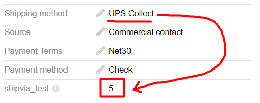

I did discover that the following:
$objectoffield->shipping_method_id
at least results in the index of the shipping method correctly.
But how to get the label?

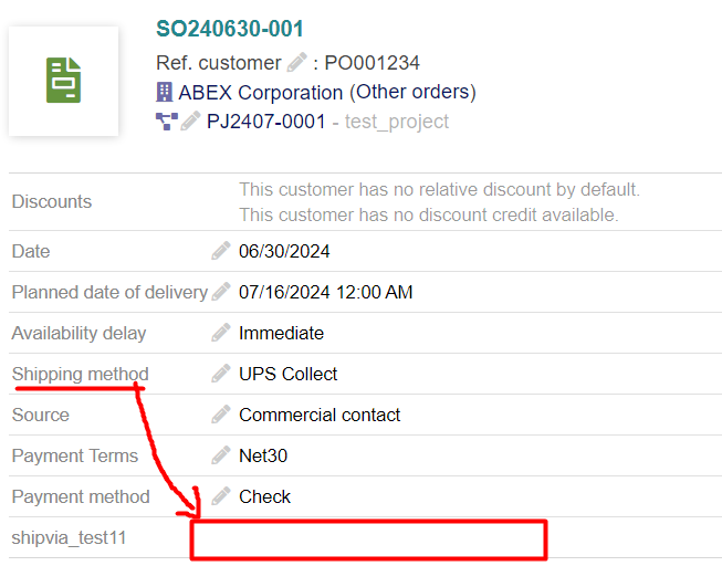

OK
I tried that as well as:
(($reloadedobj = new Expedition($db)) && ($reloadedobj->fetchNoCompute($objectoffield->id) > 0 ? $reloadedobj->shipping_method: 1))
I did not get the “Bad string syntax to evaluate (found chars that are not chars for simplestring):” error.
In fact, I got nothing at all. (blank)
Any other ideas?

@DG-Rilling
Thanks
I just tried that. The result was blank.
Are we looking in the correct place? Where is the Sales Order “Shipping method” saved?
I think this solution is very close:
Result:
This appears to result with an Index # (5) for the selected “Shipping Method”.
Does anyone know how to change the result from the shipment ID to the shipment Label?

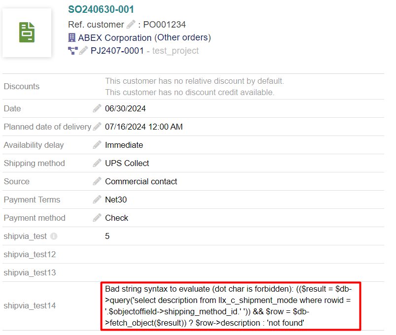

?I’m confused?
The label is shown above in the “Shipping method”.
Why did you need this again in a computed field?
Anyway you can use:
(($result = $db->query('select description from llx_c_shipment_mode where rowid = " '.$objectoffield->shipping_method_id.'" ')) && $row = $db->fetch_object($result)) ? $row->description : 'not found'
@DG-Rilling
Thanks
I just tried that with the following result:
Any more ideas?
