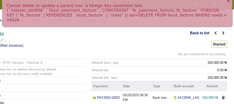

Pls is there any one who can help guide as to resolve the below?
What do I need to change at the DB side to resolve this?
When I make a payment and what to delete it and then the invoice, the payment refuses to be deleted and when I try to delete the invoice, it pops the error in second image.
FOr me to remove that, I had to go to the DB, paiment -facture table to delete that entry before I can remove the entry.
Pls I need help.
Thank you

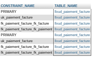

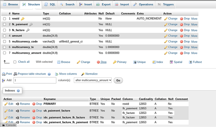

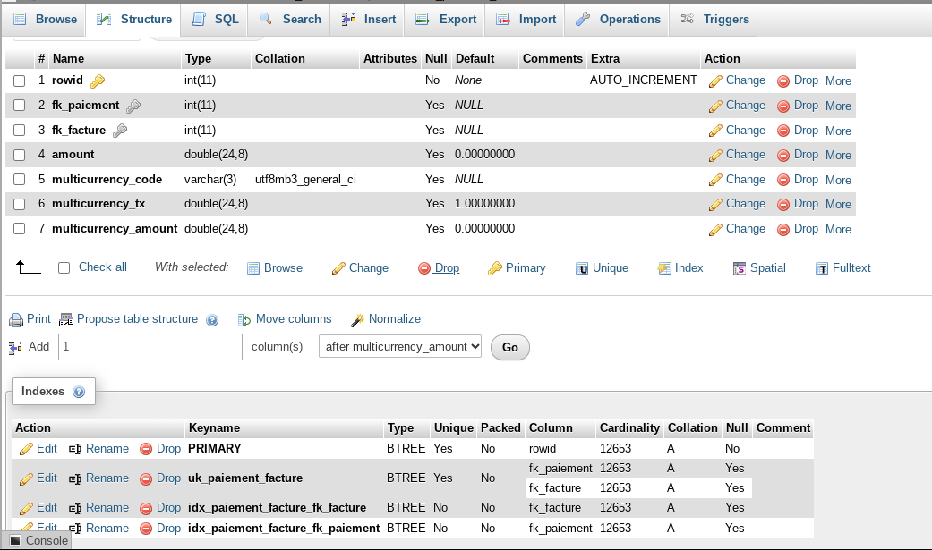

Further discoveries from the DB are seen in the image below
there are duplicates, How do I get those duplicate removed?

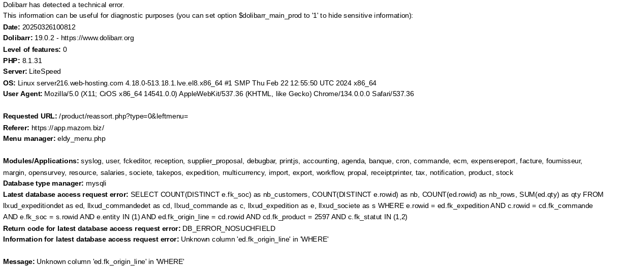

And now the Stock module, has given an error when we want to check stock as seen below
what do I have to do?
