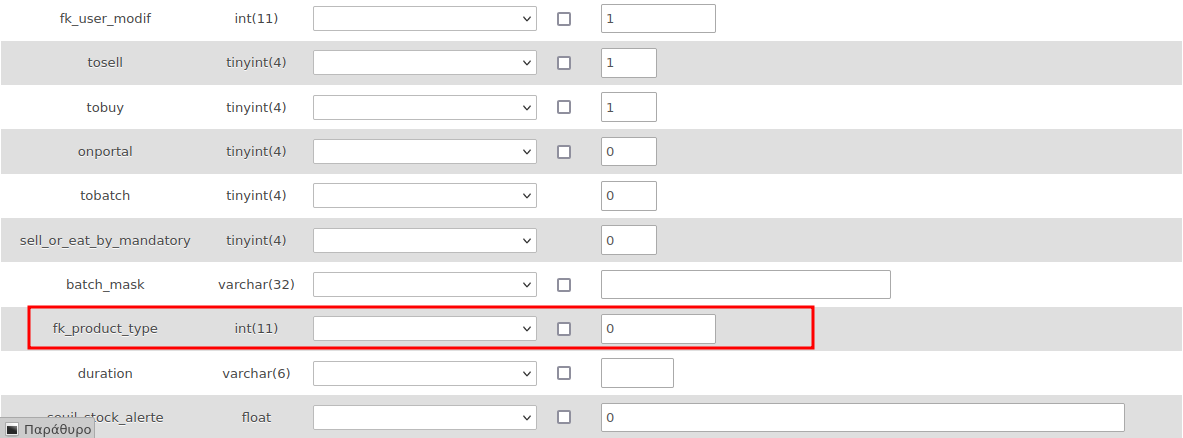

Hi @Tiritibambix
In llx_product table
fk_product_type integer DEFAULT 0, – Type of product: 0 for regular product, 1 for service, 9 for other (used by external module)
So in theory updating from 0 to 1 will do the job.
If you use stock, wherehouses or other manufacturing related modules though there might be implications.
I suggest you backup first, test your changes and then move on with your work
Hope that helps
Thank you for you answer.

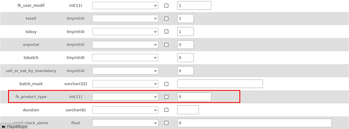

Forgive my ignorance but I found the page and the line but don’t know how to edit it.
Would you give me a hint ?
It has to be done manually for each product from PhpMyAdmin for example
I’ll try and learn how to setup phpmyadmin and connect it to my dolibarr db.
Thanks for the informations.
I simply used DbAdmin.
It was strajght forward and worked flawlessly.
