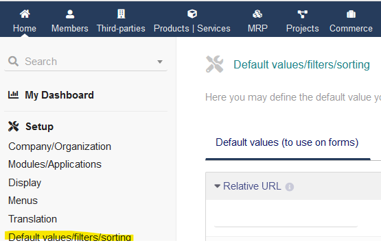

Have you tried with Default values/filters/sorting ?
Perfect, thanks very much.
