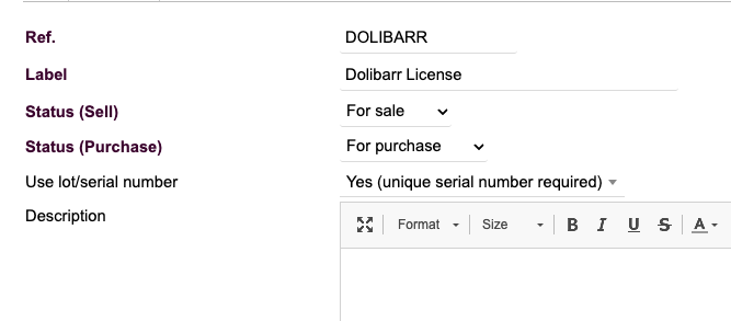

no the lot number is attached to the product. so for exemple created a product dolibarr. It requires lot/serial number that are unique:

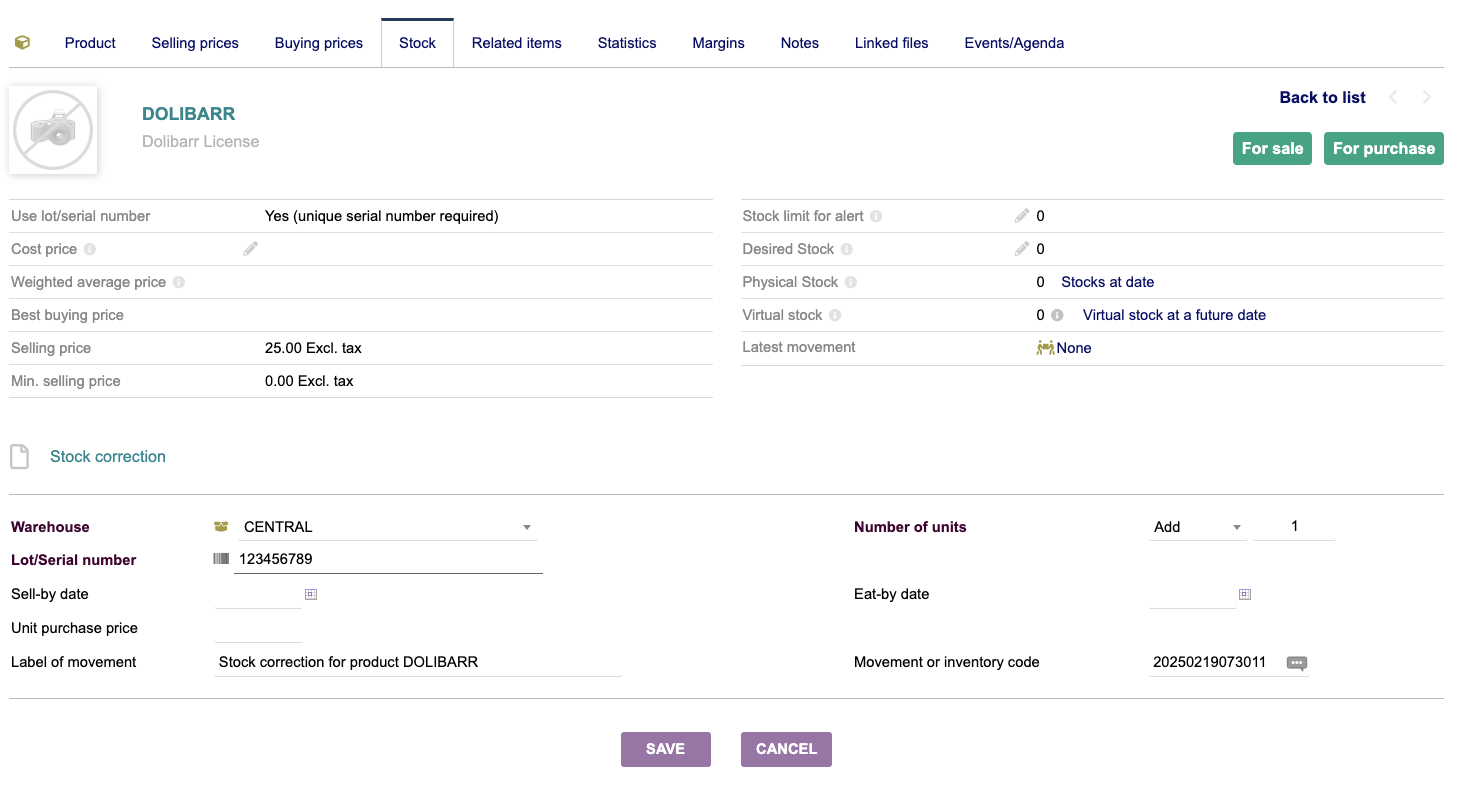

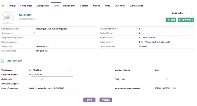

I then go to the stock tab of the product, click on correct stock and add my"stok" of my first license

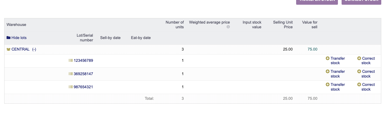

I can add/create as many as I want

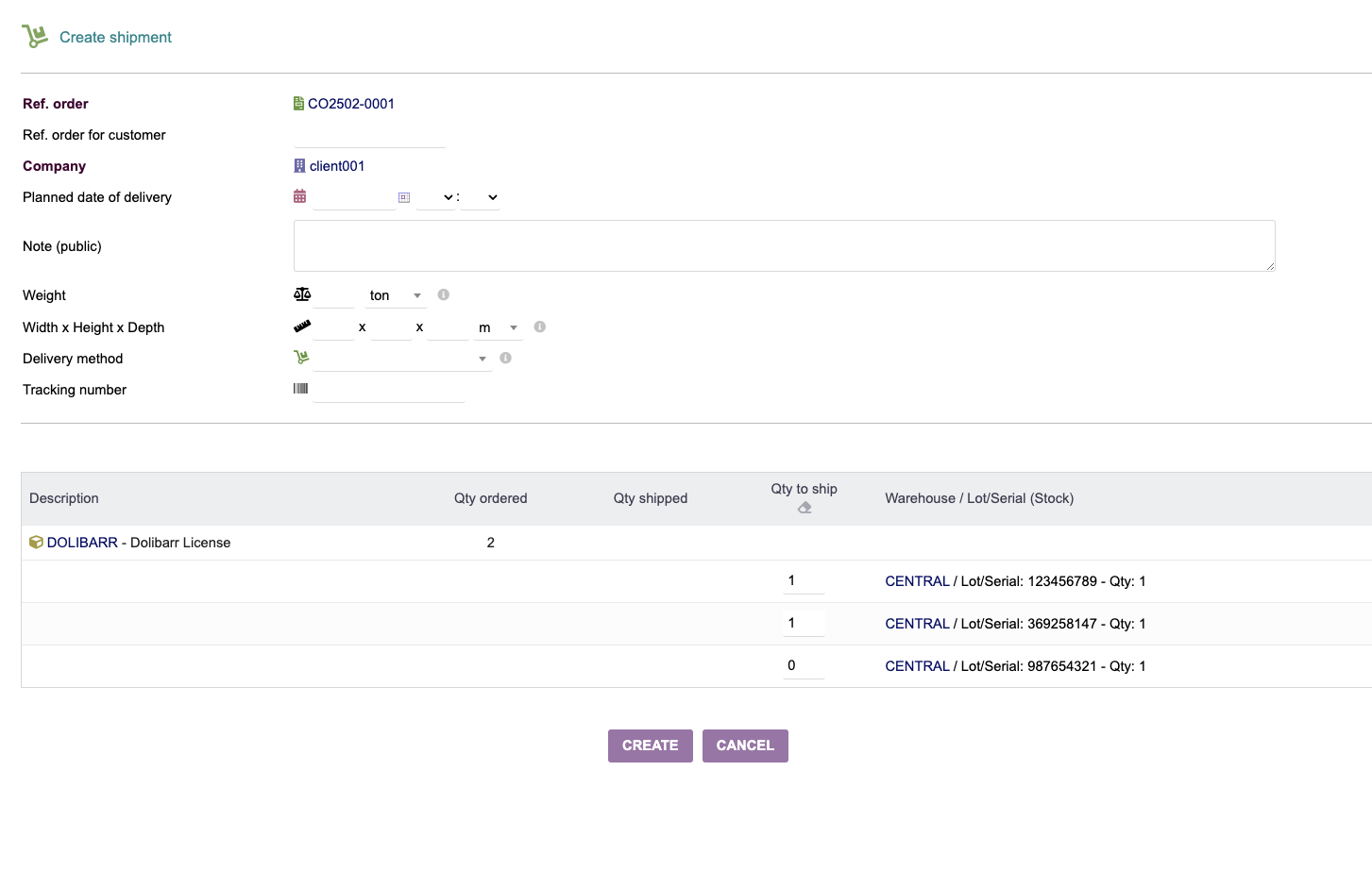

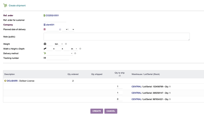

and i can use them in shipment
