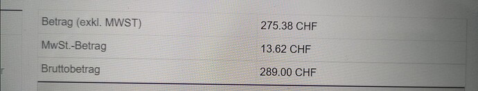

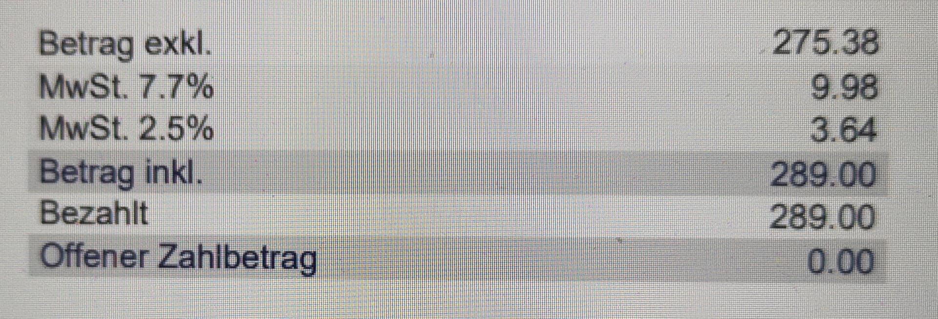

Following question: While creating an invoice I have products that have the option to use standard VAT rate (7.7%) and for certain special products the reduced VAT rate (2.5%). That all works perfectly fine - for the PDF invoices.
However, the invoice summary shows only the sum of the two VAT rates → However, for the government forms I need to fill in the individual sums (it is not allowed to “mix” the VAT rates). The only way to get the two values is to open the PDF invoice - that is cumbersome. Is there a way to display the separated VAT values (as in the invoice).
Example
These values are in the PDF invoices:
Can I display those values here (instead of the sum):

It’s possible, but some files need to be edited: the template file for the invoice in “/core/modules/facture” and “/core/lib/pdf.lib.php”
In the first one, you set where the column will be and what will be its size, and in the second - the data for the column.
