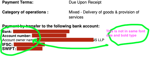

Edit Bank Details format and layout
I’m trying to customize the font size and arrangement of details in my display. Ideally, I’d like it to look like this:
  • Account Owner:
  • Bank Account No.:
  • Bank:
  • IFSC Code:
  • SWIFT Code:
However, currently, it appears differently. Could someone guide me on how to achieve the desired format?
Screenshot 2024-07-15 at 19.00.38

do you mean in the PDF?
Yes, in the PDF. Do you know how to fix it?
I think you need to fix it in the template that is used to create the document
@jonbendtsen I have tried editing the below portion which i think is used for displaying the bank details:

But I’m not able to set default font size, bold/italic alignment or any other text formating tweaks for the bank details the way i need as a final format output.

You find the formatting details in ~/htdocs/core/lib/pdf.lib.php:
function pdf_bank(&$pdf, $outputlangs, $curx, $cury, $account, $onlynumber = 0, $default_font_size = 10)
bold line:
$pdf->SetFont('', 'B', $default_font_size - $diffsizecontent);
normal line but with smaller (-3) fontsize
$pdf->SetFont('', '', $default_font_size - 3);

Here is how I fixed it.
All changes are made in the ~/htdocs/core/lib/pdf.lib.php file.
Under the Bank Section:
*  Show bank informations for PDF generation
$pdf->SetFont('', '', $default_font_size - 2)
To rearrange the bank fields, I modified this portion:
	    // Account owner name
	    $pdf->SetFont('', '', $default_font_size - 2);
		$pdf->SetXY($curx, $cury);
		$pdf->MultiCell(100, 3, $outputlangs->transnoentities("Account Name").': '.$outputlangs->convToOutputCharset($account->proprio), 0, 'L', 0);

		$cury += 3;
	if (!empty($account->bic)) {
		$pdf->SetFont('', 'B', $default_font_size - 3);
		$pdf->MultiCell(100, 3, $outputlangs->transnoentities($bickey).': '.$outputlangs->convToOutputCharset($account->bic), 0, 'L', 0);
	return $pdf->getY();
did you consider submitting a Pull Request ?
I didn’t consider it because I couldn’t figure out how to maintain this format for the India region only (conditional logic), as other countries have different formats/layouts.
Another challenge is that this is captured under the ~/htdocs/core/lib/pdf.lib.php file, which gets replaced if you upgrade your Dolibarr version, unlike your Export templates, which remain intact.
