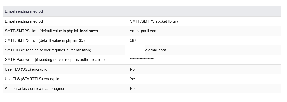

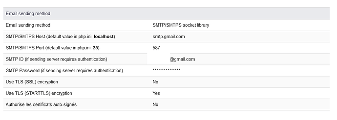

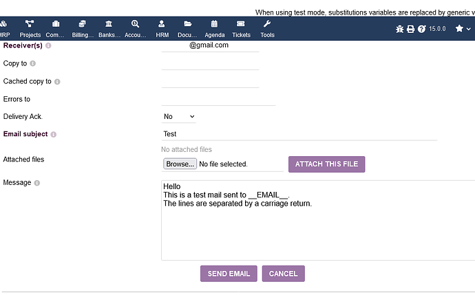

Hello Mr. Lukmcd; This is how I up and running the email system

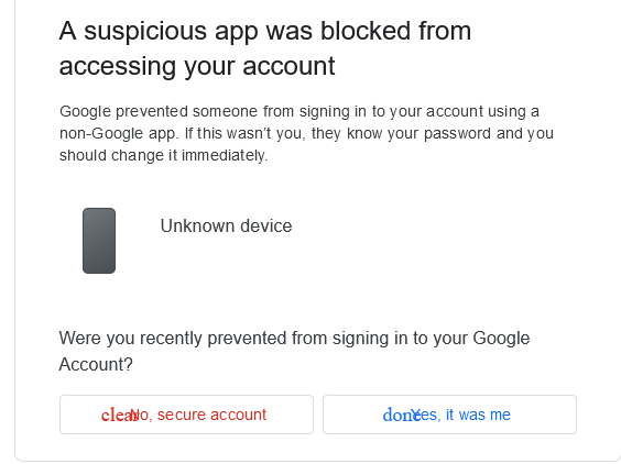

then you need to take care of gmail/google server

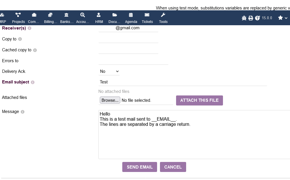

email2

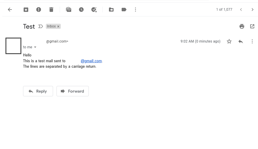

Testing and On my Case it is working:
I received it from my Email:
Thanks for that detailed response ! I’m still it certain what the issue is with my hosts email. I can get a test email but not a “production” email. Gmail does in fact solve the issue. I’ll keep that configuration for now.

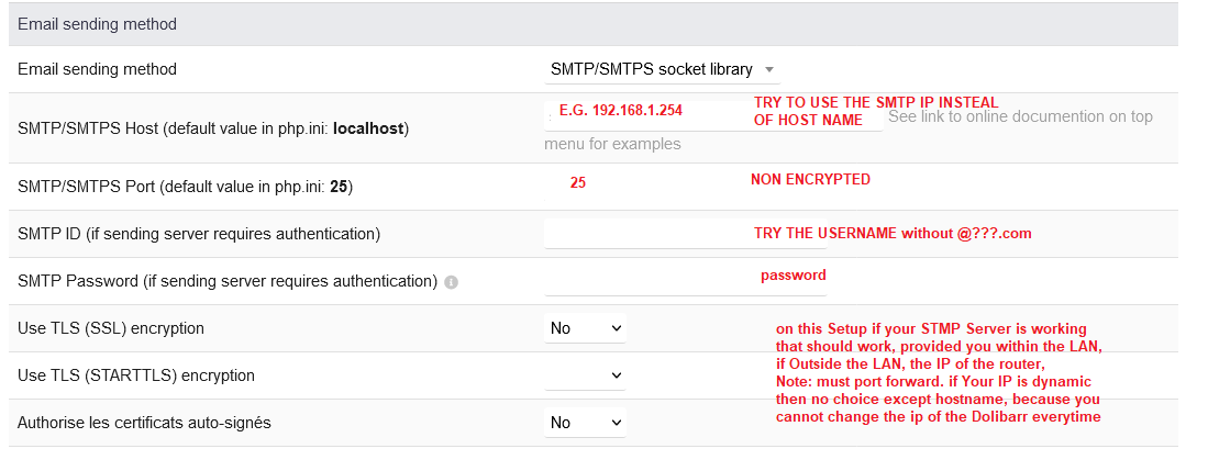

Sir Lumcd, You need only to inspect the configuration of your inhouse hosted STMP server, the trigger, such as: port, ip, and your router config, on your smpt server, you need to see the parameter wether accepting the IP. All you need to do is to unblock the port on the router.
