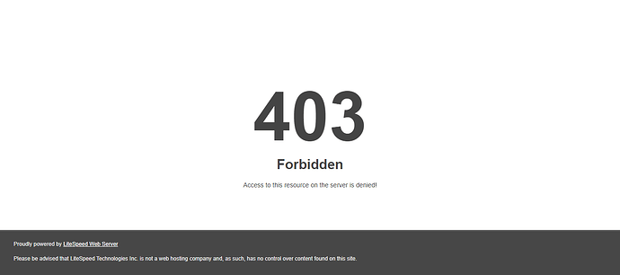

Error 403 Forbidden When insert Logo in Company Setup
I just installed dolibarr, when setting up the company, I get a 403 error message only if I fill in the logo field.

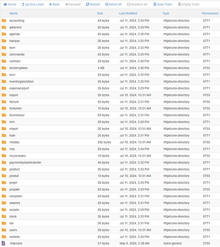

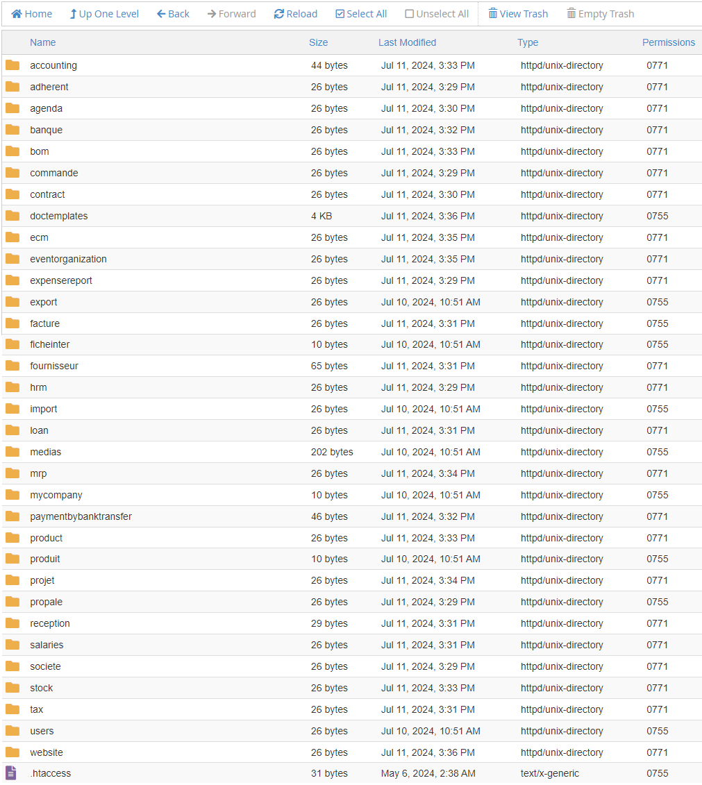

i found “dolibarr_main_data_root” and i found mycompany folder. permission 755
what should i change?
edited: i change it’s permission to 777, but it still gave me 403 error
that is the wrong permissions. Use 755.

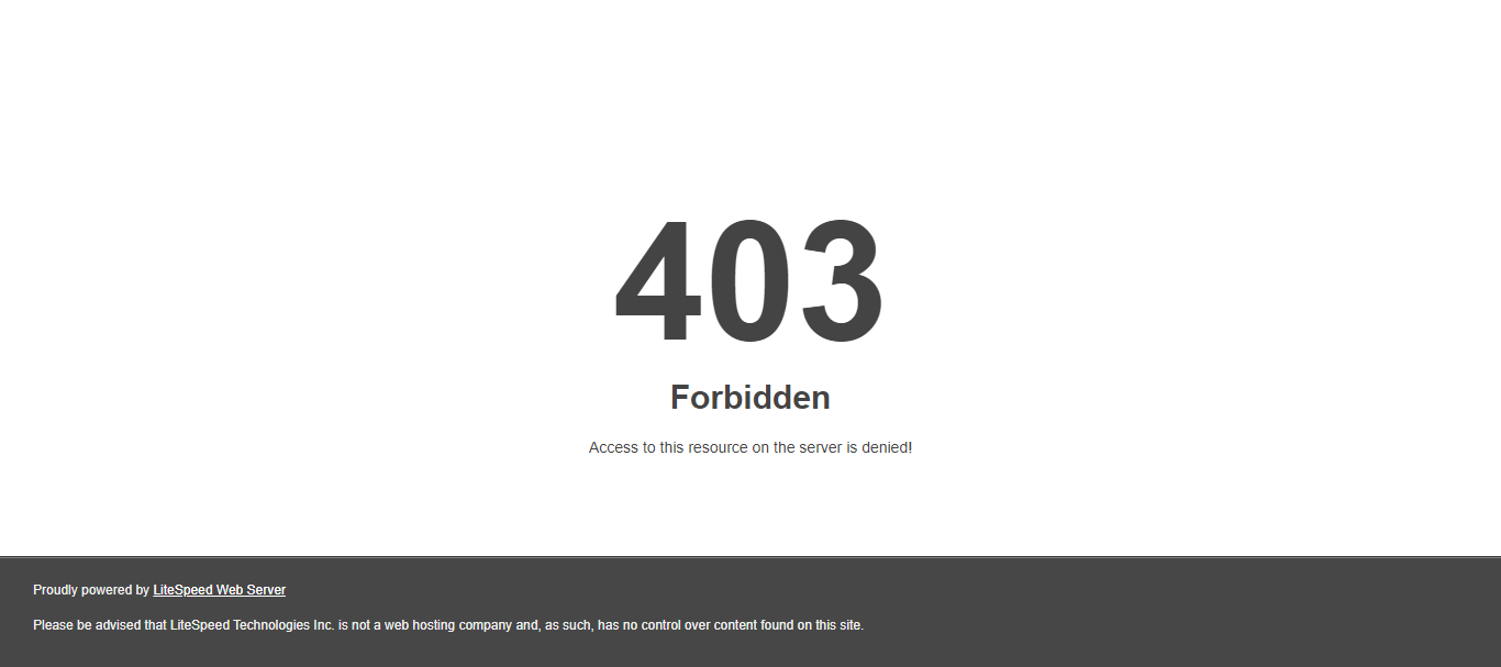

Send us a screenshot of the error.
Send us the output from the apache log, and apache error log, and also the output of dolibarr.log
NO not all of the text, just the relevant text related to this upload that fails.

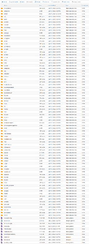

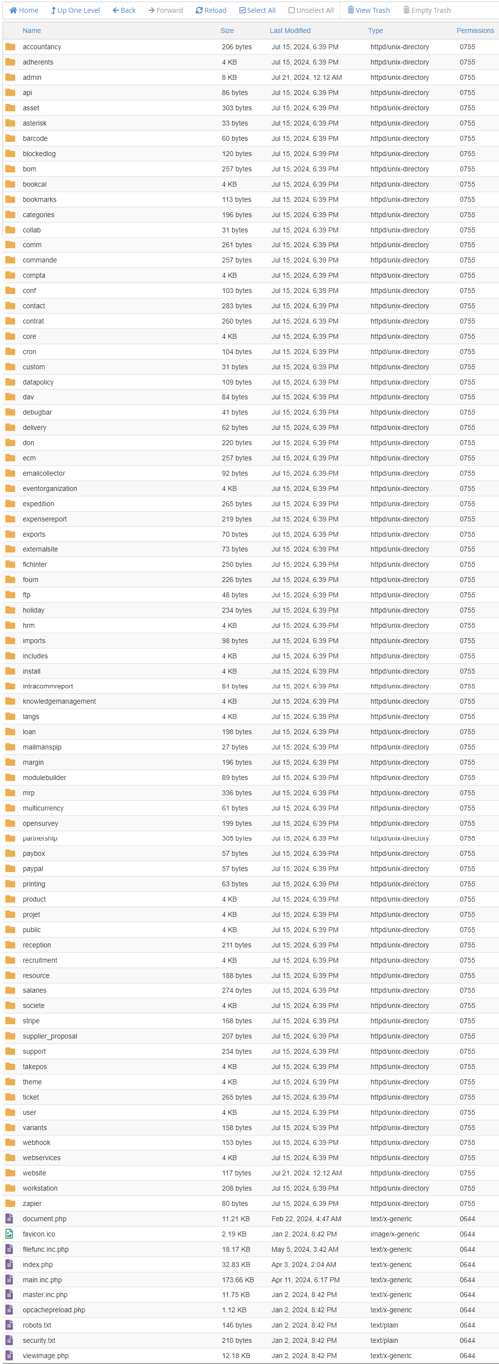

which folder path was that photo from?
i’m trying to upload my logo (local folder from my latop) in company setup
that answer was not what I meant.
You posted a screenshot of a folder. What was the path of that folder in that screenshot?
/home/webstati/citrainternusa.my.id/crm/
and this was at /home/webstati/dolibarrdata/
