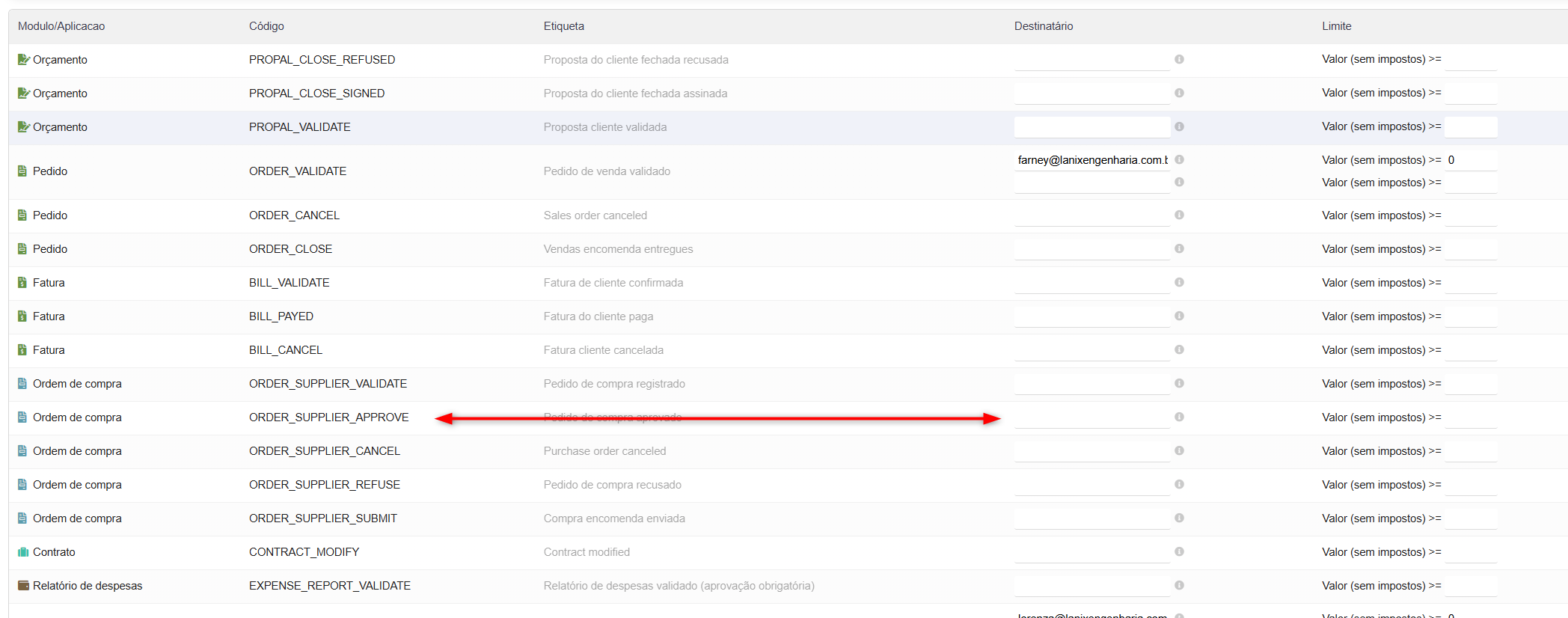

But I did some tests here and realized that perhaps the error is not in the module of suppliers but notifications.
In this specific activity a notification email was redirected. I removed these emails and it worked.

In fact, I am in trouble is the module of notifications, when I am inserting the email to receive notifications these errors are happening. If you remove these notifications the system works normally.
Same problem for me.
I had to remove the email notification to make it working again.

There was this error due to the notification module interfacing with the financial module. Until the staff identified what happened, for security reasons I disabled the notification module.
