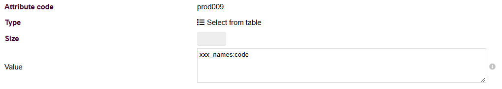

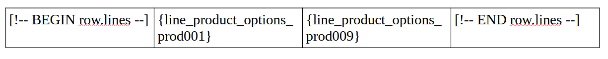

I have an ODT template, and when I generate it, the extra field with ‘Select from table’ is pulling the rowid instead of the code. I want to get the code instead of the rowid
and whatever i do when i generate the odt it will take the rowid instead of the code.

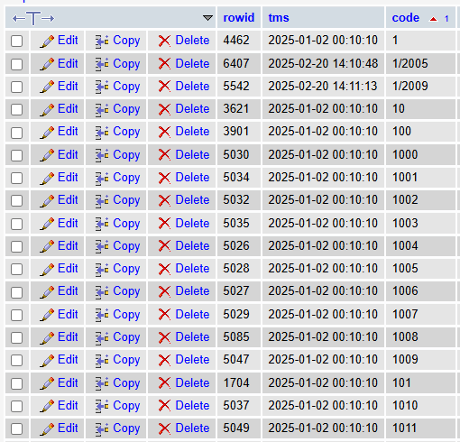

The code is the last column from my table in the database - see picture no.2
What is strange that in dolibarr filter or selection it shows correct but in the odt template it takes the rowid information

The answer was xxx_name:code:code (tabel:label:id) - the answer was right in my eyes :slight_smile:
