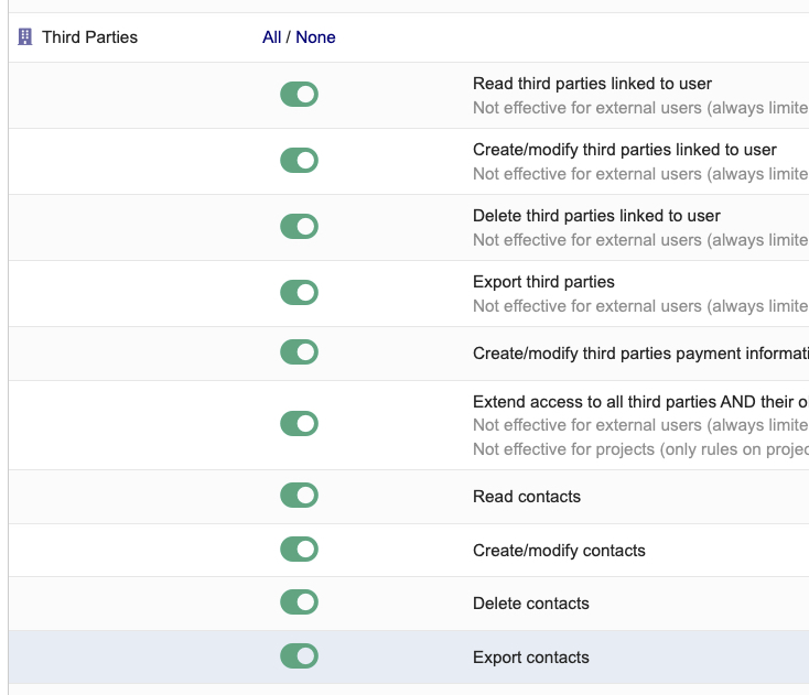

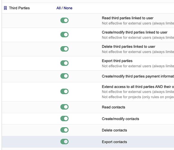

The rights for 3rd parties are:
Unless the 3rd parties are linked to user then they have access to those 3rd parties:

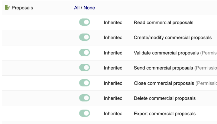

I’ve attached pictures of my users permission in Dolibarr. I do not thinkt hat Dolibarr currently have a permissions that is needed to do what you want to do. I think you need to either code it yourself or hire a coder to make it for you.
