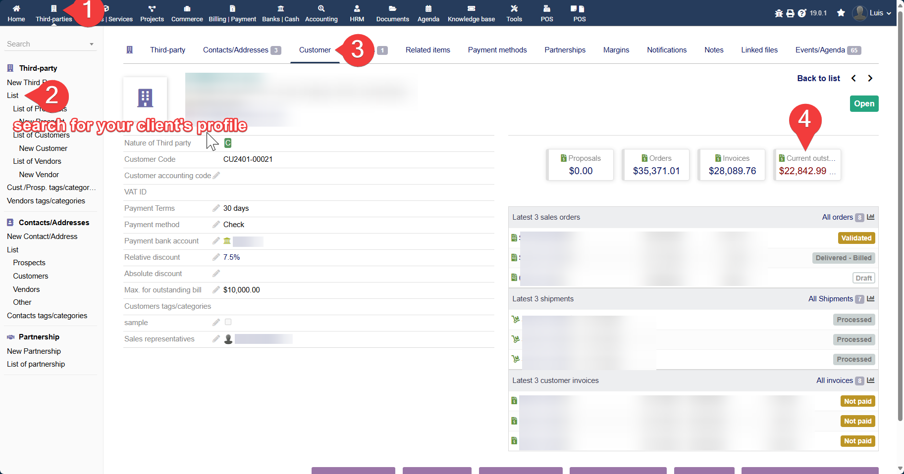

  1. As @Plows mentioned, your bank account only records real money transactions, money left to be paid does not appear there. You will find that information under your client’s profile though.
  2. From an accounting perspective, a credit record is money coming in, while a debit record is money going out. As the $1000.00 is yet to be paid and has not really left our account, that $1000.00 should appear in your accounts receivable account (chart of accounts), not in your bank account.
    If you click on #4, it will give you a list of all open invoices, as well as any payments related to them. Basically the view you are looking for
