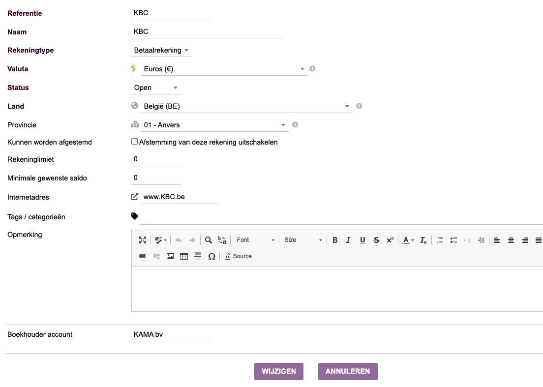

thanks for your reply, that is just the problem, when I click modify I can only change name, type, valuta, country but not Iban, Bic/swift, address and so on…

Hello :slight_smile:
Can you try this : you load the bank account and you hit the “Modify” button
In your address bar, you must have something like :
/compta/bank/card.php?action=edit&token=xxxxxxxxxxxxxxxxxxxxxxxxxxxxxxx&id=yy
in the address bar, try just adding “&type=0” and check the results

my url ends on: …&id=1
I changed it but then I get a blank screen.
top bar is still there and left bar too, but nothing in the body
did you try …&id=1&type=0
or try with …&id=1&type=1
when I hit modify it is:
bank/card.php?action=edit&token=****************&id=1 and I can not make any changes like changing Iban, account number and so on
when I try bank/card.php?action=edit&token=****************&id=0 I get a blank screen in the body, the navigation stays
Maybe a weird question but coukld it be browser related? This is not the only bug I am getting. I just wanted to check a shipment as send and also there I get a blank screen.
I overlooked this: &type=0
Just changed the 0 to 1 but now it seems I can change it
