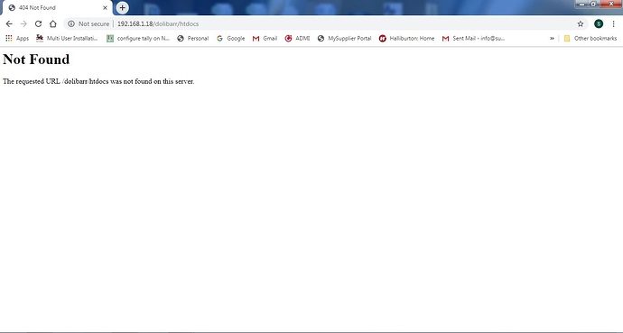

Thanks For Reply,Meanwhile Please let me know how to ensure that wamp is running smoothly,cause i tried on my 2nd PC with typing on browser XXX.XXX.X.XX/dolibarr/htdocs but its not work.

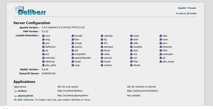

To check if your wamp is working or not you can do the following -

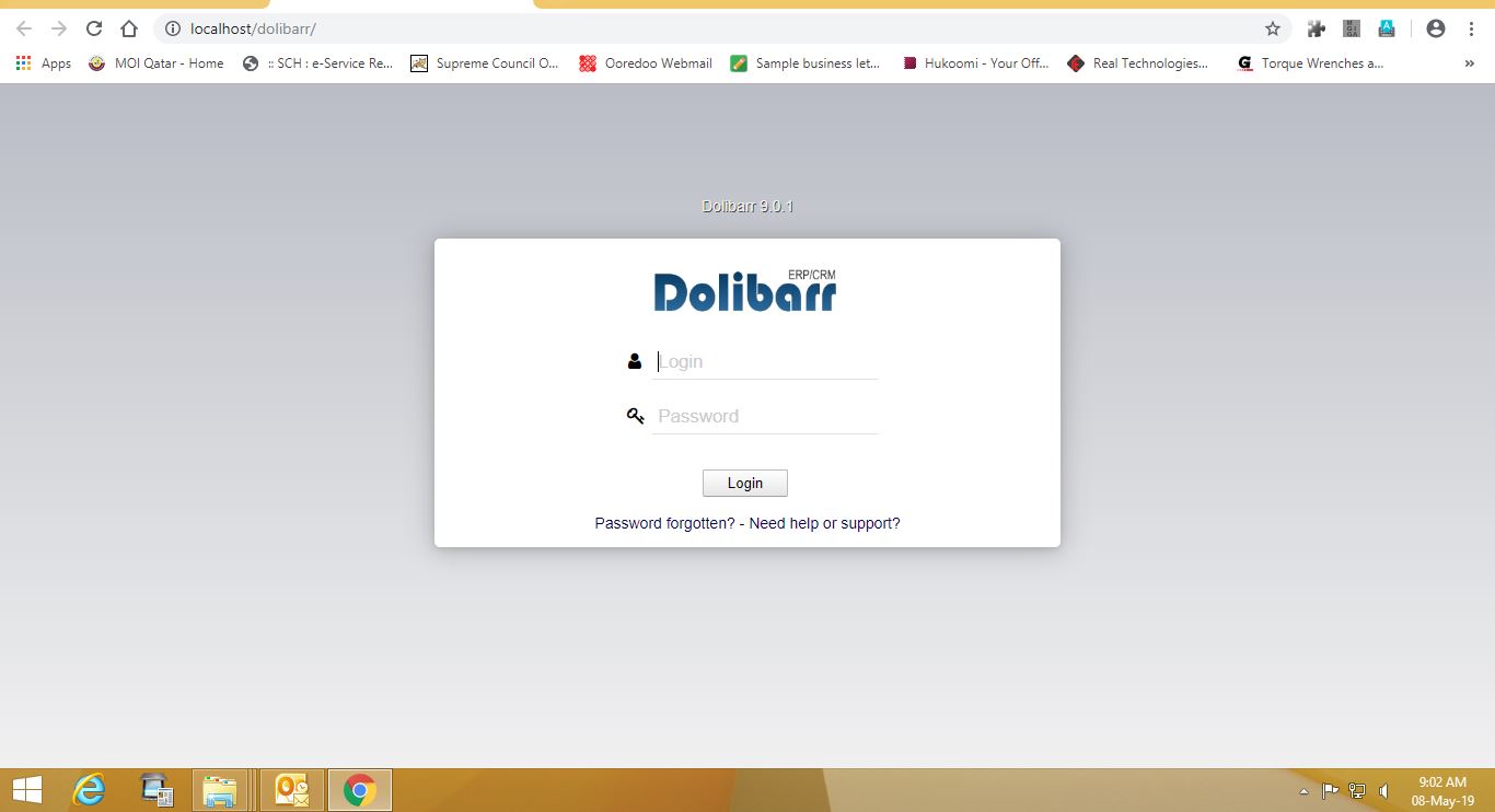

After installation of dolibarr, can you able to run on 1st pc?
On 1st pc open browser and type following - http://localhost/
if you see Apache page without any error means your Apache is working.

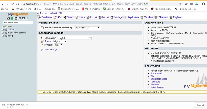

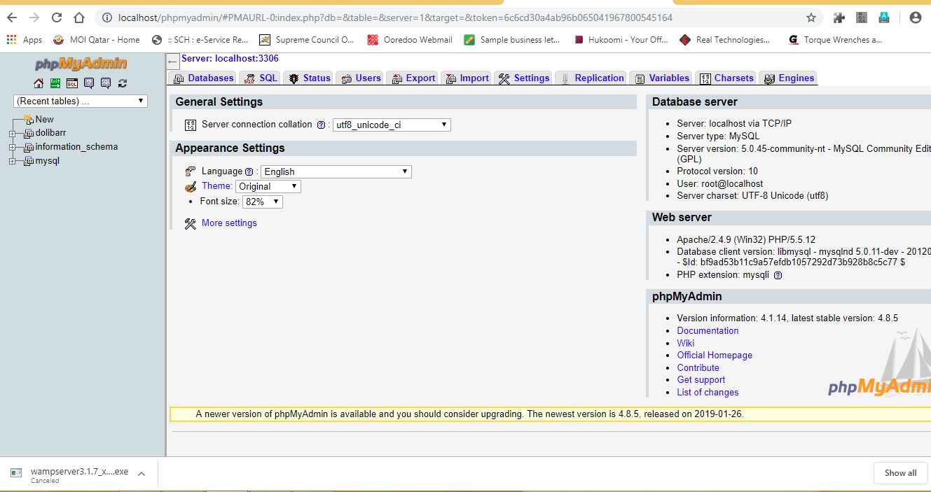

You can also type this to check if Mysql is working - http://localhost/phpmyadmin/
this will take you to database management Mysql, if it open without error means its working too.

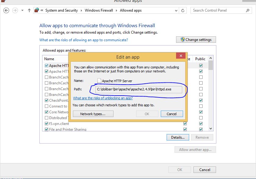

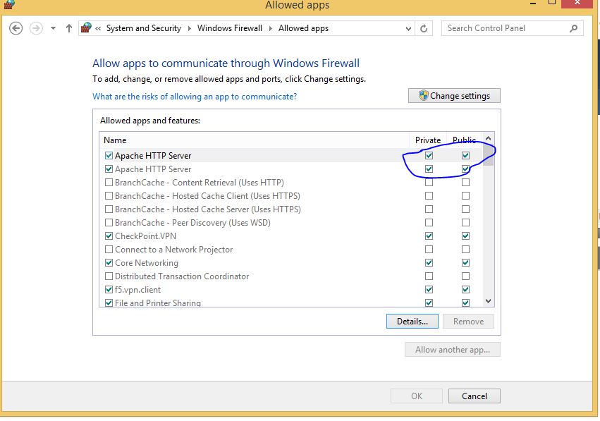

However, if you absolutely must only allow access locally, then you must make the necessary configuration changes to the WAMP installation to allow outside access/access from another computer. There are several aspects which need to be correct or it will not work.
This is NOTHING to do with Dolibarr.
You should search for “allow local network access to wamp”, and you will find many step-by-step guides that explain how to do this.
I Can Open Local Host & Mysql but still i unable to open dolibar from my 2nd PC
in video it’s shows connection of wamp server only and nothing has described about opening from 2nd PC
