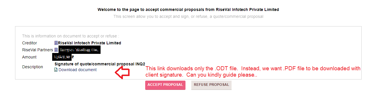

Can you kindly help on the know-how to provide only PDF version of generated files for Proposals, Invoices, and Purchase orders since providing editable .ODF file may not be safe business practice.
For example:
https://dolibarr_url/public/onlinesign/newonlinesign.php?source=proposal&ref=XXXXX&securekey=Hashp of the file&entity=multi-company id
downloads the editable ODT file and not the PDF file to the external customer.
I hv checked the file and understand the ecm->share is being used to hashp and the object $ecm in commonobject.class.php relies only on last_main_doc which is an ODT file.
Interestingly, the table llx_ecm_files contains share for only the .ODT file and Null for the .PDF files.
Can you please help how to allow to download only the .PDF version of Proposals, Orders and Invoices to external people and NOT the editable .ODT versions…

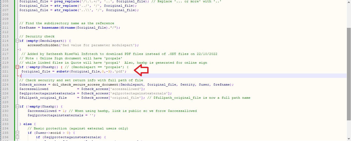

Quick work around is to touch /htdocs/document.php file and make the following changes:
This works fine for me in 16.0.0. If any one found any where else to be changed, please let me know. I am sure you don’t like to give a quotation that can be editable by customer !

Ok, but you modify the core file, meaning that your modification will be erased at each new version you will put…
I think, the best it’s to try to modify the /public/page where you have the download link, either by a module or proposing a core change on GITHUB.

The PDF file can have a hashp into the db.
For the moment this is possible and done automatically if a hidden option that allow sharing of PDF is set (so still in dev). By default no sharing is done.
To suggest core change, if less than 100 lines of code, just send a PR with core change.
If more, may be you can create a issue to let the community give feedback of what you want to do to avoid to waste your dev time.
