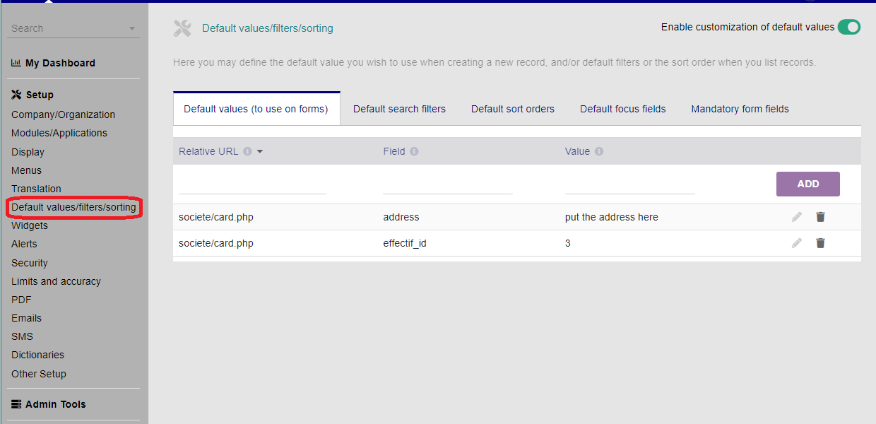

you can do this, with Setup, Default values/filters/sorting

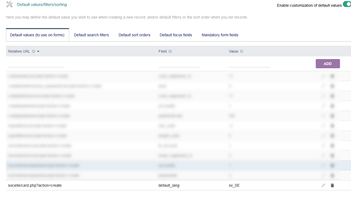

I don’t get it. Since “Payment type” is not showing during customer creation, how can it be set with “Default values/filters/sorting”?
I use this to set the default language to a customer during creation, because the field “default_lang” is visible during creation, so it gets set. But “Payment type” is not shown, and I cannot set it.
