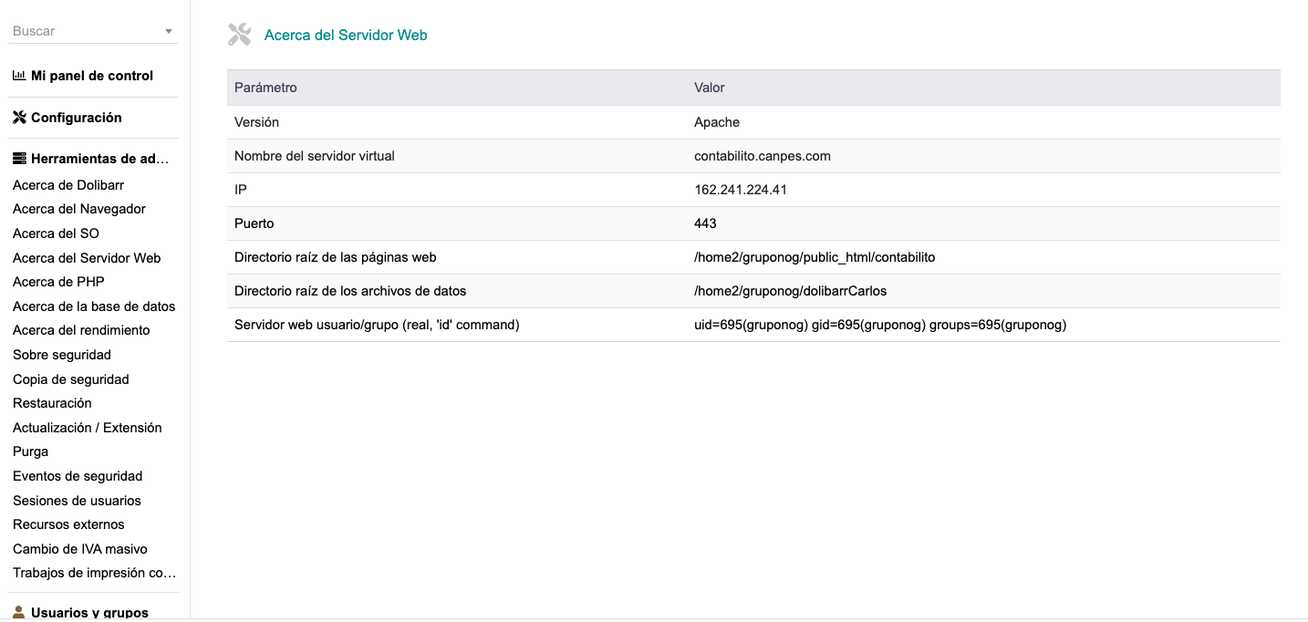

I can't find the documents directory to add the install.lock file
I can’t find the documents directory to add the install.lock file
help
It is listed in Home > Admin-Tools > About your webserver
(not sure if the English transaltions match exactly).
hello,
I don’t see the “documents” folder there to be able to put the install.lock file
In the shown table, there is a line specifying the “Data files directory”. The stated file path ends with a folder called “documents”. This is the place where the install.lock needs to be.
does not appear.

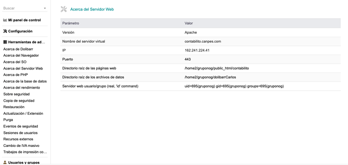

there is the image.
I have even checked the cpanel, where I checked the root directory of the website and the root directory of files. but I can’t find it.
The screenshot clears the confusion up.
My Spanish is unfortunately just minimal, but I would go for the “Directorio raiz de los archivos de datos” - probably the standard name of the document folder got changed during the installation of Dolibbarr. So the install.lock then needs to go into the folder dolibarrCarlos.
