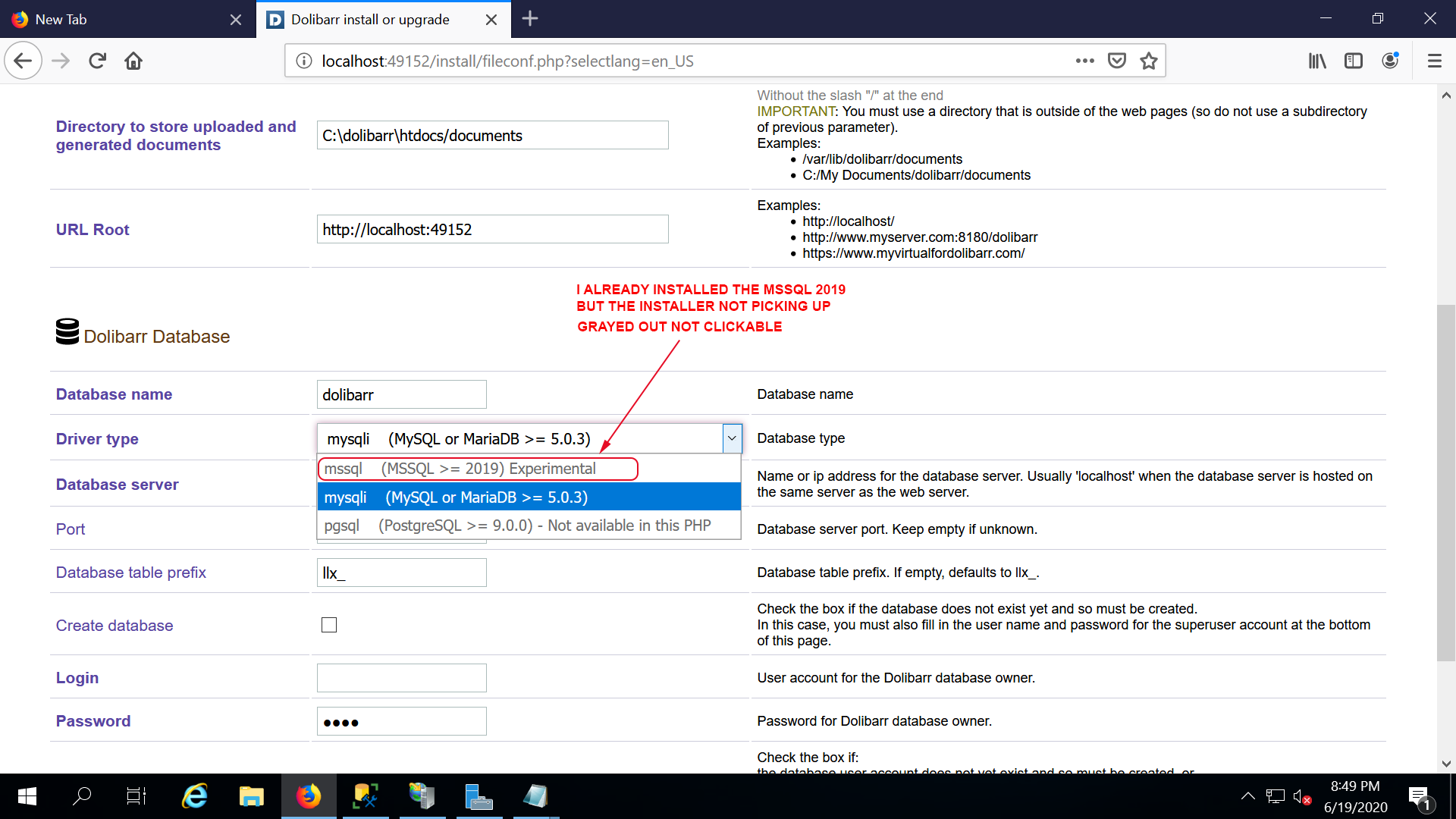

Can someone Please guide me which file to edit in order to activate this MSSQL 2019, because I just want to know how is Dolibarr running on MSSQL 2019, only for Testing Purposes.
Thank you Mr. Eldy
Support of MSSQL is not working. There is no way to enable it. It will probably be abandoned. It becomes very difficult to find people using this old database nowday (even if name is MSSQL 2019) and native driver has been abandoned in PHP itself.

To have Dolibarr compatible with anyother sql platform, there is only one file to change (the db driver), like it was done to support postgresql. However because mssql is not an open source software, it is not possible to validate and keep testing environment for it, also the number of users was very low so there driver for mssql was abandonned a very long time ago (too few people were using mssql compared to other available database and no developer was interesting in maintaining it)
