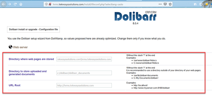

I am currently evaluating Dolibarr. I have successfully tested the application on my localhost and it is working awesome. Now, I am installing it on my Windows Plesk Hosting. However, I am getting the following error message:
"Failed to include_once(“G:\PleskVhosts\teknosyssolutions.com\hrms.teknosyssolutions.com/core/db/mysql.class.php”)
You may have typed a wrong value for parameter ‘Directory where web pages are stored’.
Go backward and correct wrong parameters. "
On the Installation page before this error, the Web Server section contains some fields, but all these fields are disabled. I tried to set up the “$force_install_noedit” variable to 1 to enable the parameters, but only DB parameters are enabled.
How I can properly set the web server parameters?

mysql driver is not supported anymore from dolibarr 5+
You need to use $dolibarr_main_db_type=‘mysqli’;
Thank you for the answer, but the problem was due to doliwamp package that I was installing. This package has all predefined settings and cannot be changed.
