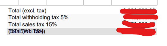

Two taxes are configured and applied at the invoice. Problem is that on the total area, the line items are overlapped. Screenshot attached. Please suggest.
which dolibarr version?
Version is 20.0.2. this is the latest version
Which model are you using ?
As there are 2 models, can you try with the second one ?
Both the models have same overlapping issue.
Can you create a free test instance from www.dolicloud.com then reproduce the setup to generate the trouble and then create a ticket to the support team from the dashboard, menu support, contact us…
Sure, let me get back.
I figured it out, the issue was due to translation override string. Previously I configured it for Total Tax → Total Sales Tax. When it was displayed due to the long string length it overlapped. I change it Total Tax → Total ST, now its fine with no overlapping.
