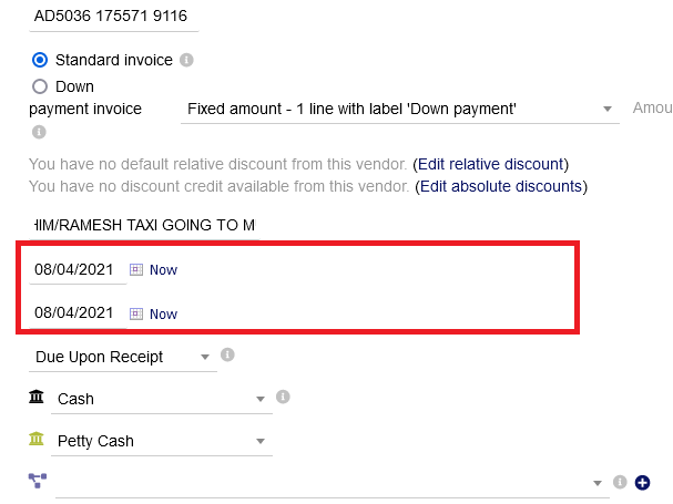

The date on the Dolibarr ERP system that i am running both is American mm-dd-yyyy
How can we change into dd-mm-yyyy without going to PHP setup?
DATE DOLIBARR
As it show I re-entered the Petty Cash fund but These date is too American, How to do it in the European way such as it Much be 04/08/2021 i mean dd/mm/yyyy. I tried to look on the Setup.

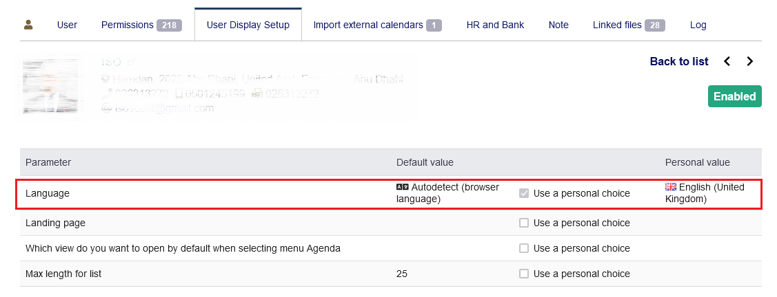

Date display format rules are defined by the display language you chose, probably en_US. If you switch to en_GB or some other english variant, you should have the format you expect. If you don’t want to switch language, you can specifically change the related translation strings by overloading them in Home/Settings/Translations. Search for keys starting by FormatDate.
Regards,
Marc
Thank you, It is working, It means that each of the Users can setup his own Date, But does this effect the Database Data?
