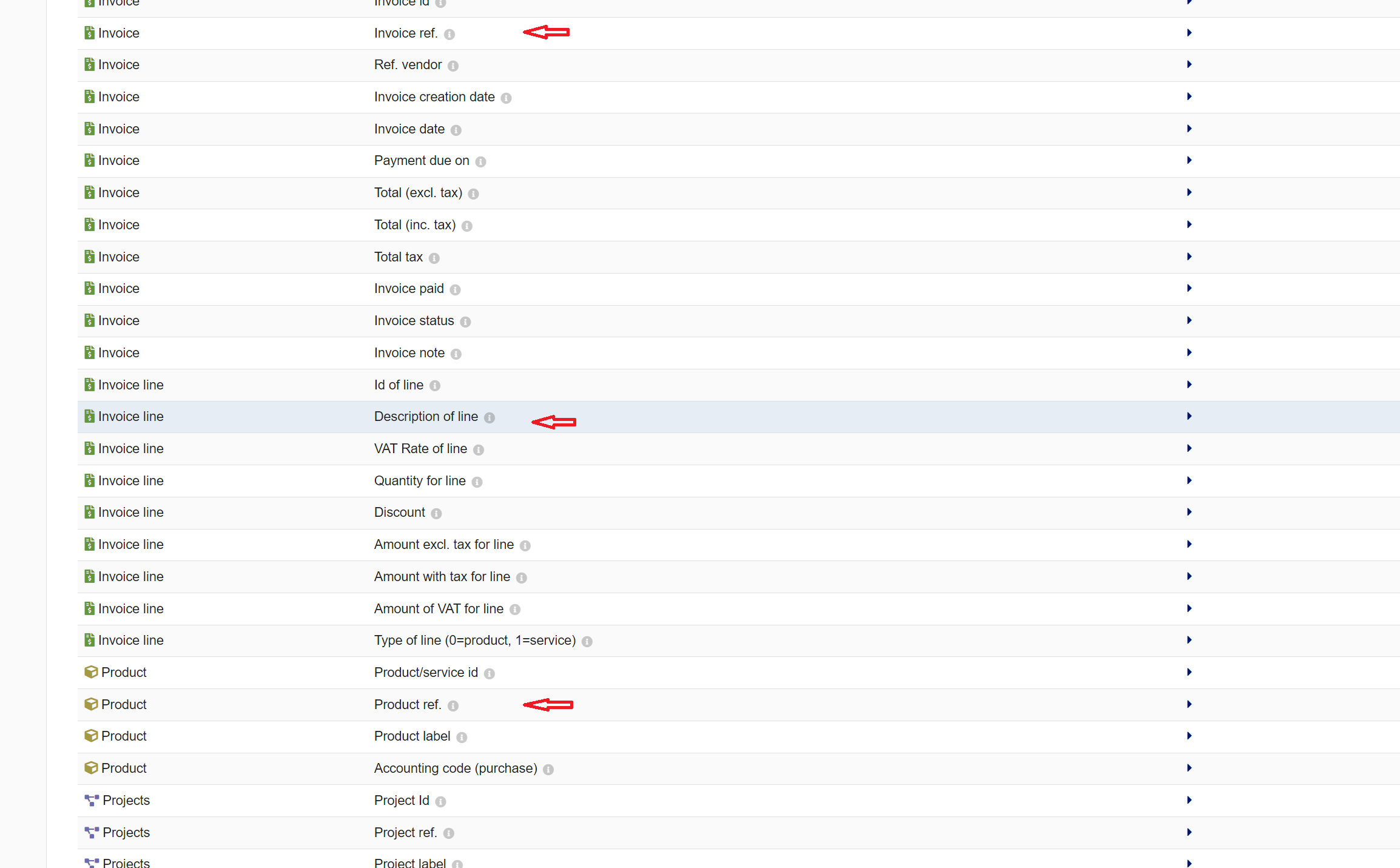

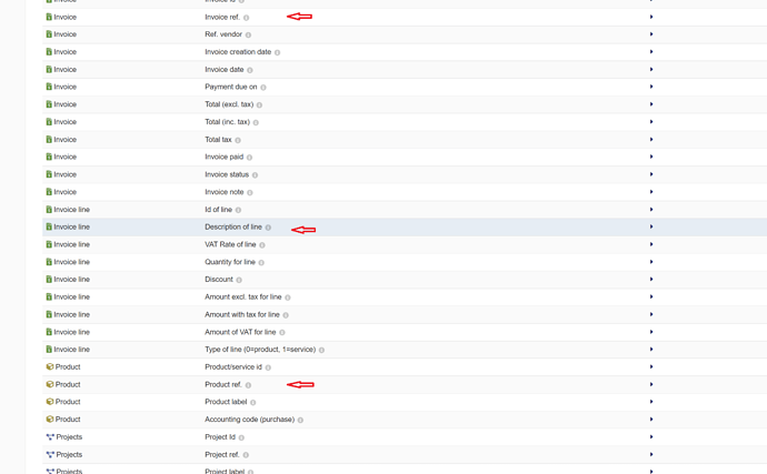

Tools >>> Export >>> Vendor invoices and invoice details
In the next step you can filter the output by any of the chosen fields (i.e. by supplier id, by date, etc.)

I have tried that just to see where the data sits (the
buttons give you the field names) but the product reference from the supplier lines comes up empty.
Have you tried your suggestion to the end until the export is done? (I am using 15.0.1 btw)
