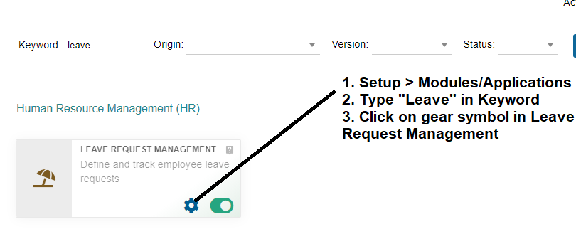

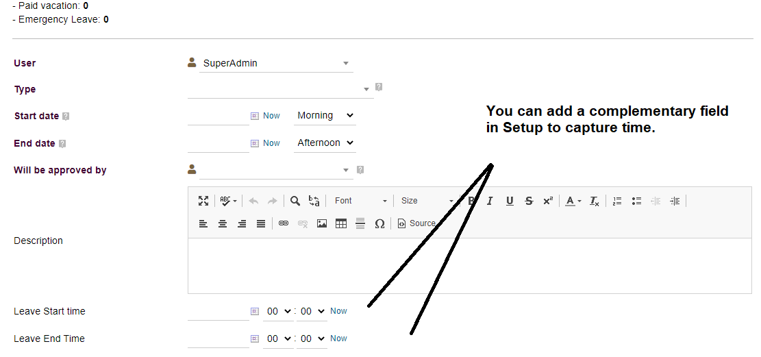

A simple solution is to add complementary field like this:
To create a complementary field,
If you are particular about redundancy, look and feel etc, check this link:
myField : personalization of fields and of their access

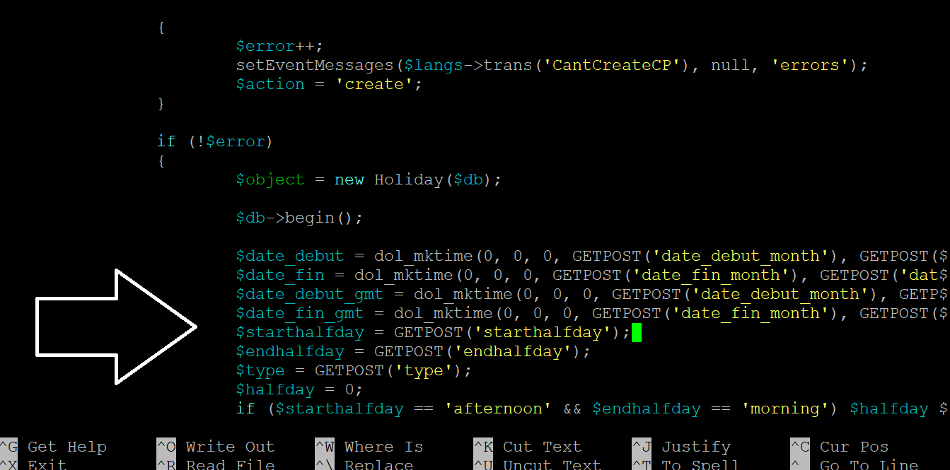

If you a techie, try to play with /holiday/card.php and look for date fields and modify them in date and hour.

I did try to use complementary attributes. I use a type Select field with times as values and trying the one you suggested the date and hour type field.

Also, I did a quick check on the card.php. It seem to have logic in calculating number of days of leave based on half day triggers. Changing this would mean to re-write the code to check the leave balance in terms of hours and not days.
I guess, its complex and cannot be done without touching the code.

I will just use the select type field with time as values.
This is just to record the time.
