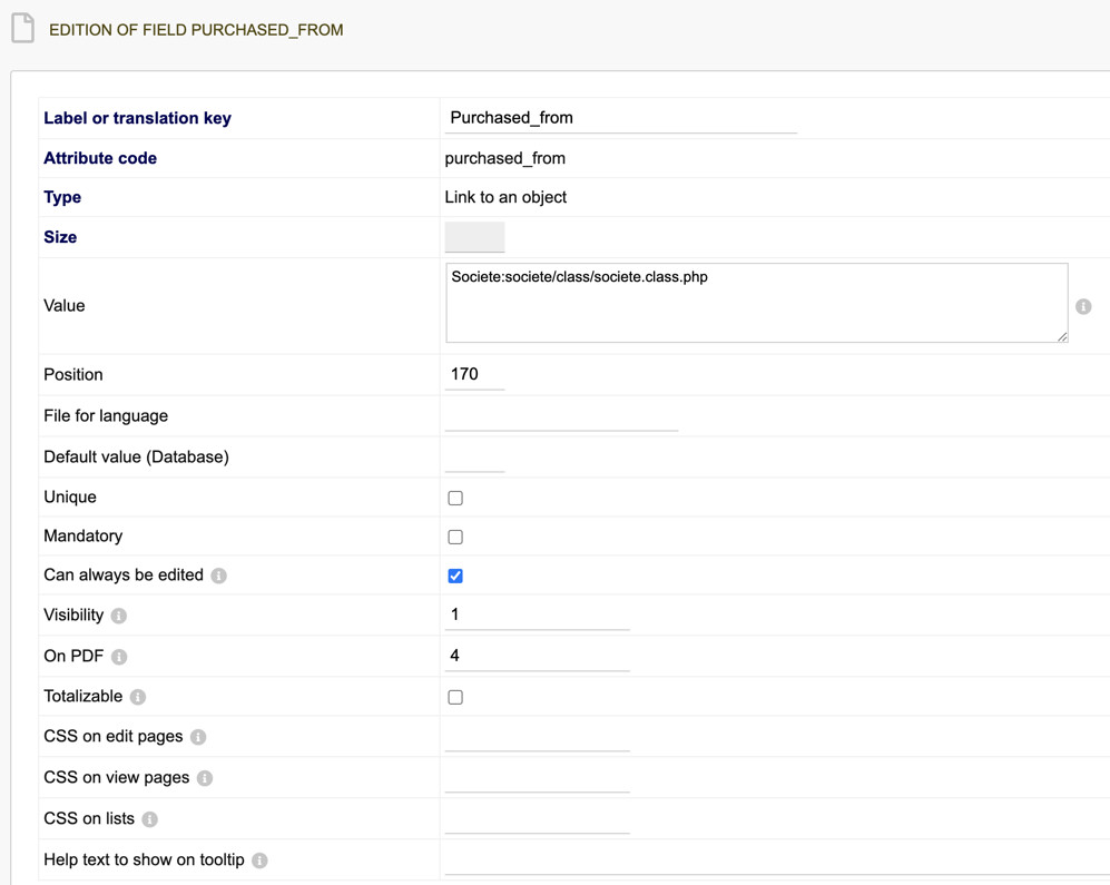

this is how I do something simular, though I link to a thirdparty, not contact.
Thanks @jonbendtsen. That looks fairly straighforward, but I’m afraid I just don’t have the background in php to understand it (yet, willing to learn).
Is there a Wiki or some other resource where I can learn how this works?
For instance, “Societe:societe/class/societe.class.php”, what is the context for it’s use?
If I wanted to link to say, the Zip Code of a third party, how would I go about doing that through this feature?

Hi guys, it is not class, it is a sql-query like this one (I used it in member-module COMPLEMENRARY ATTRIBUTES, that field connects a Member to another one as "Partner same household):
adherent:lastname|firstname|ref:ref
table:field1|field2|field3:primarykey (unique)
