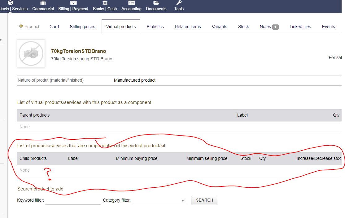

I have found that there is a kit functionality for a manufactured product, however on the Virtual product TAB, the area where I should be able to add Child input product is blank or greyed out. Have I missed a setup step to fully enable Virtual products or Kits?
Please advise?
Hi adac,
First you have to have a child products created then you can type the reference as filter or you can directly select a category and pressing the Search button. In the list below you will receive the products / services. Next you have to select the Qty, the option to increase/decrease followed by Add button. That’s it. Now you have a parent (virtual) product with one or several childs.
Thanks, but I cant seem to find how to designate a stock item as a parent or child item?
Is it found on a different tab somewhere?
No, every product / service can become a virtual or child. In your case you are going to create a virtual product that consists of one or several child products you already have as raw material for example.
Thank you, I have figured this out now, I was not searching correctly for the child product.
