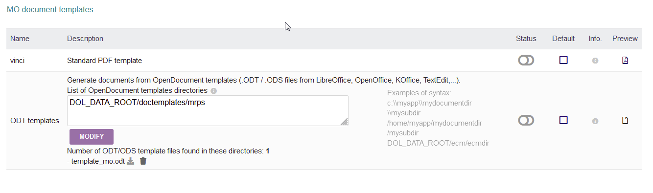

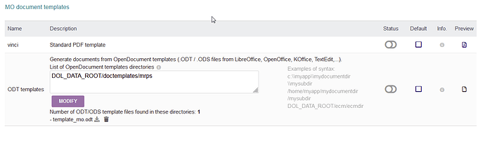

I am having the similar problem with MOs on Dolibarr 19.0.1. I am getting an error message when I validate a Manufacturing Order and it does not increase the demand for the parts that are on the BOM so then the replenishment amounts are not correct. The Error I am getting is. “Error Failed to load doc generator with modelpaths=core/modules/mrp/doc/ - modele=alpha”
Anyone got a fix?
I had that same error code, Which I assumed was part of the document generation or odt template.
The stock was moved though.
Have you tried changing the “Document template” in MO module settings?
