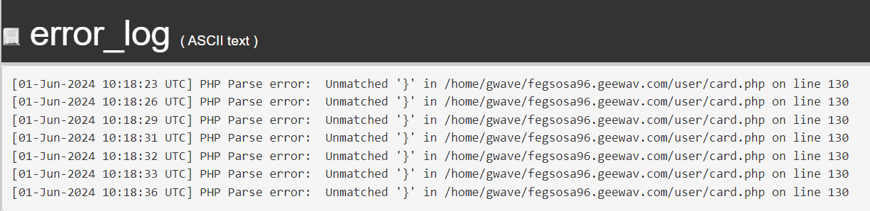

please post the exact error message, the apache logs and the dolibarr.log file from the Documents folder.
ok thank you, let me see if i can do that… from the document folder, you mean?
Does this help?

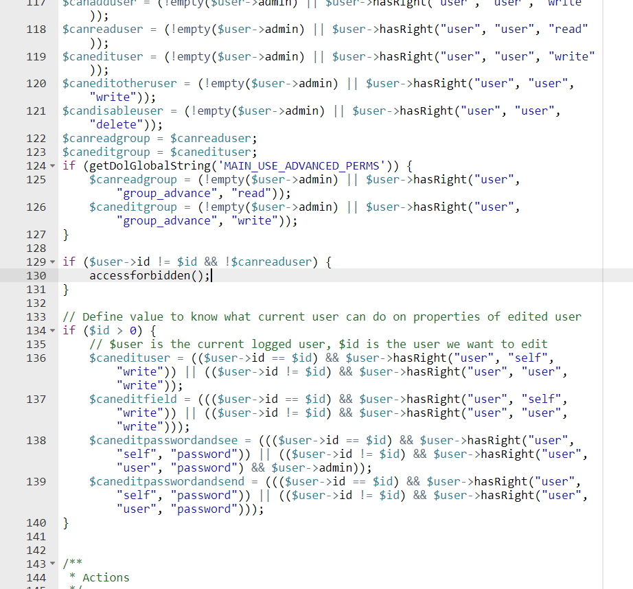

Did you edit that file?
Tested some changes on that lines of user, self, write to user , self write and reverted when it didnt work
Thank you for this awesome reply, however, i dont have the slightest idea about the above, is it that something is wrong with the code or the file itself is corrupt or …
I was counting wrongly, grep -c counts lines, not occurences. If I count with tr -c -d ‘(’ | wc -c then I get an equal amount of parentases
JonSweet16:user jonbendtsen$ cat card.php  | tr -c -d '{' | wc -c
     493
JonSweet16:user jonbendtsen$ cat card.php  | tr -c -d '}' | wc -c
     493
The line that is displayed in the error log is not necessarily the source of the error, but gives an indication of where to look.
To narrow down the error further, you can perhaps also display the content of the variables $user->id, $id and $canreaduser.
Or remove lines 129 and 131, if accessforbidden() is then executed then something is wrong with the If query.

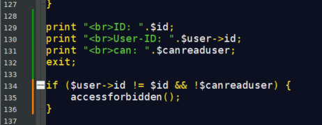

print "<br>ID: ".$id;
print "<br>User-ID: ".$user->id;
print "<br>can: ".$canreaduser;
exit;
if ($user->id != $id && !$canreaduser) {
accessforbidden();
This shows the content of the 3 variables and then stops execution.
Thank you so much for this guide.
Just to be sure i understand, The code to display the …, am i to add it to the query? if yes, where should i add it? and if no, how would i test…
To remove lines 129 - 131 you mean i should comment on the lines so that it wont execute right?
Add the 4 lines as shown (in your example: after line 127)
grafik
Then try again to modify the user.
Now you see 3 lines similar to
grafik

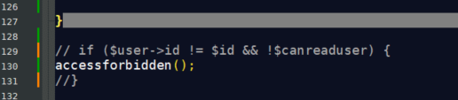

Not remove 129 - 131, only comment line 129 AND 131. It looks like this:
grafik
Now you see hopefully the page “Access denied …”, if so then the problem is related to the if-query (PHP bug?)

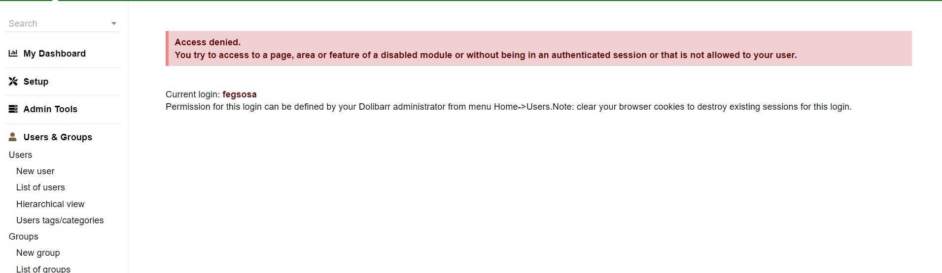

Ok, using the display, this is what i got
User-ID: 1
can: 1
But what does it mean? Does that mean because the values for the admin number and user number are not same, that is why access is denied?
I want to comment the lines 129 and 131 to see the result
The image is the feedback after commenting on lines 129 and 131
What could now be the issue to be resolved?
Ok, accessforbidden() is working as expected.
