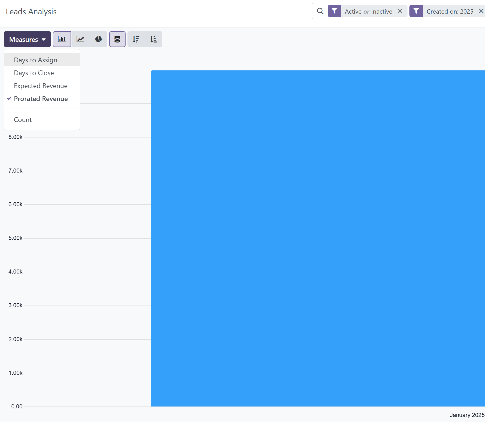

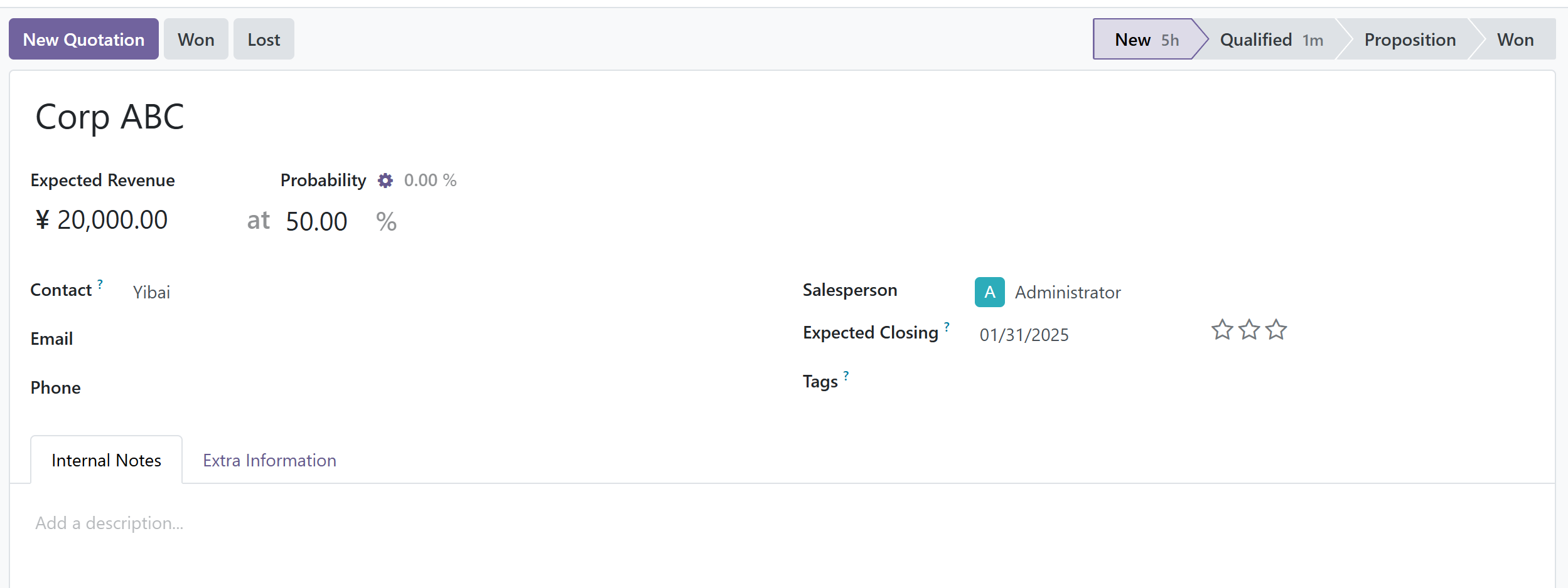

I am comparing Dolibarr and Odoo, and this is almost the only thing for which I like Odoo more.
