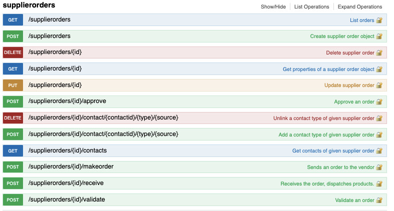

may i trigger create orders by cron/api
yes, you can create orders through the API, but there might be a module that can do actions, though I don’t remember the name of that module because I don’t use it
thanks a lot, but also the Replenishment Orders ? or create the Replenishment Orders automatically?
@lblabr Maybe? I think you should try it. The picture is from the API explorer found under Tools in top menu, and then API explorer in left side menu

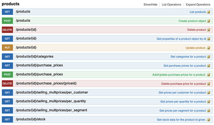

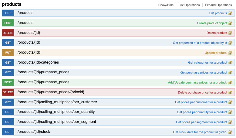

You can find stock contents using the API
so something could use the API to check on stocks and then order if necessary.

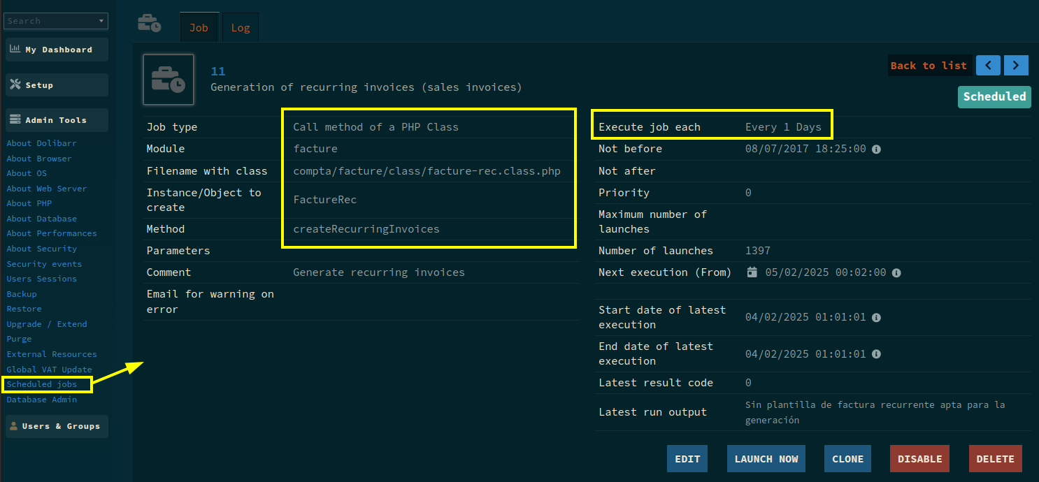

sounds great how do i do that?

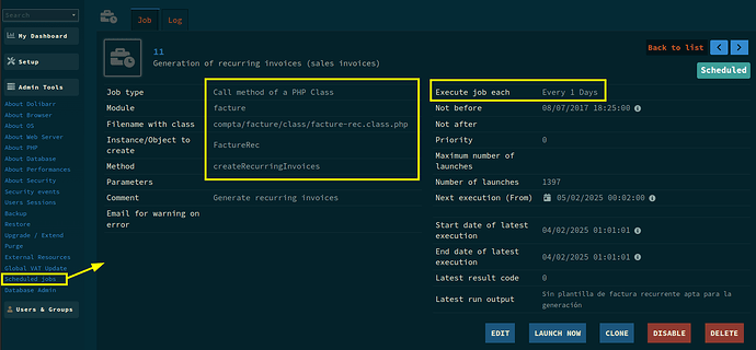

You must visit “Admin Tools” / “Scheduled Jobs” and add a new Job.
This one I’m showing here is for generate recurrent invoices for customers once per day:
Briefly: you must know which function must be called on which PHP file and put it there. Sincerely, I don’t know which function and file you need to call to generate self-replenishment purchase orders. Making a bit of searching in the code you will find “easily”.
By the way: this mechanism will work for you if you need or prefer to create your own PHP script to do other things. So is quite powerful and YOU DON’T NEED API’s neither MAKEs or ZAPIERs :sweat_smile:

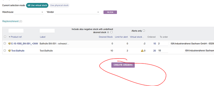

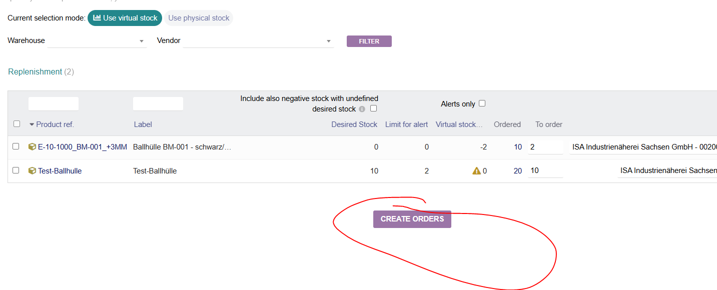

so far so ggod, what doe i need to call?
as it looks to me, the orders are collected by the data, the you may select by webform, and with th ebutton the orders are created.
but how to that with wich code?
