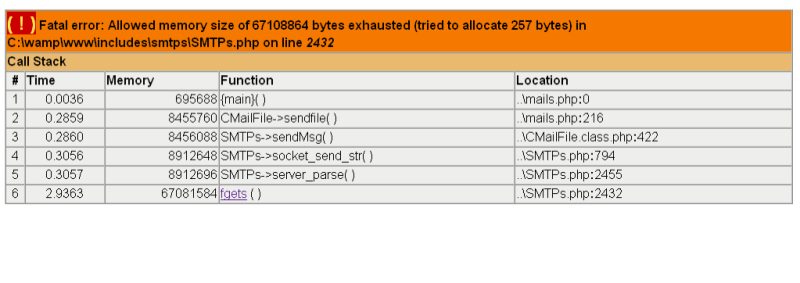

when I’m trying to send an email via smtp (I have the correct smtp info)
it gives me the following error:
Fatal error: Allowed memory size of 67108864 bytes exhausted (tried to allocate 257 bytes) in C:\wamp\www\includes\smtps\SMTPs.php on line 2432
what should I do?

the problem is that when I send emails from an address such as dolibarr@domain.com (or any other) the email works great, but when I try so send an email with my domain e.g myemail@max-security.com, the email does not work.
Does the message is still
If yes, go into menu setup - php and check for line
memory_limit
What value do you have ?
yes it still says:
the memory_limit value is 512M
What is your dolibarr version ?
Having a memory_limit of 512M and a message saying 67108864 bytes exhausted is very strange. Can you provide a copy-paste of page " menu setup - php " ?
Dollibar version: 3.1

memory_limit 64M 512M
