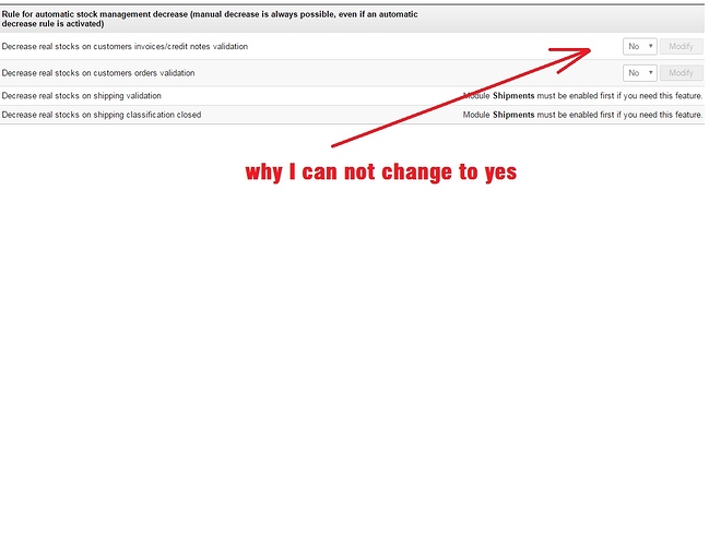

hello,
Please can you help me?, I have no ideea why I can not activate automatic correct stock afther payed invoice.
I tried to acctivate “Decrease real stocks on customers invoices/credit notes validation” to yes, but the botton modify is not active(i can not thake to yes).
see picture:http://imgur.com/a/tBybj[img size=1]
http://http://imgur.com/a/tBybj[/img]
Has there been any reply to this. I happen to have the same issue on the current version 18.0.4. The checkbox is grayed out. I cannot click on it. I have turned on all the dependent, yet, module still the same
Most probably because of the permissions.
As an administrator, I have all the permissions by default. Yet, I can’t click to check the box.
I would then suggest 2 things, check the logs of your user, maybe you get some direction there. But more than this I would double check that the specific permissions are ok for each module.
Also maybe that something was not correctly set up on the database during the install/upgrade. So try to look into the database tables.
