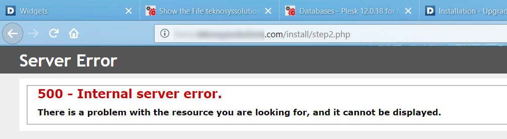

The installation starts successfully. However, after the end of step1.php and just when step2.php is accessed, I get the 500 Internal server error. The same thing successfully works on the localhost system. So, I have set the max_execution_time to 90000 in the PHP settings file. Also, the same setting is done in the step2.php file. However, I am unable to resolve the error. The solution is really required so that I can use this application.

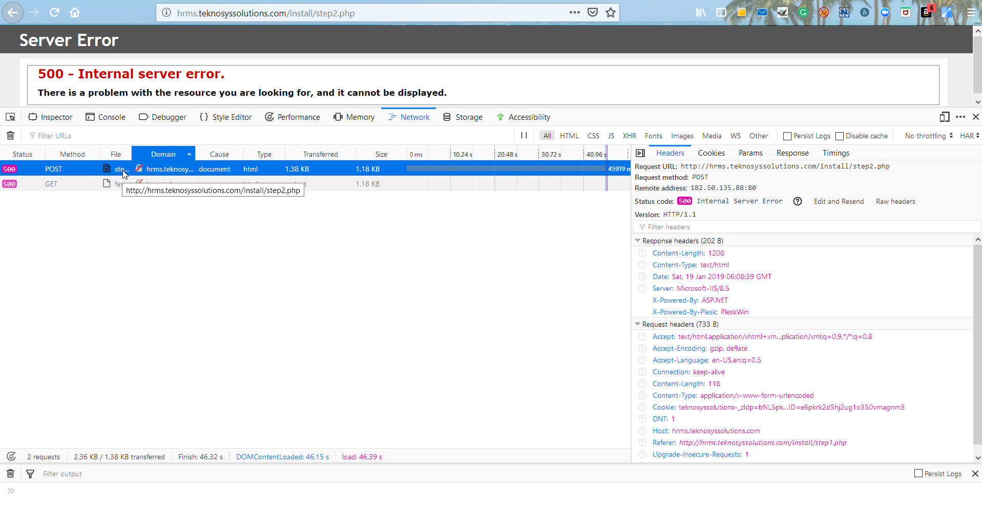

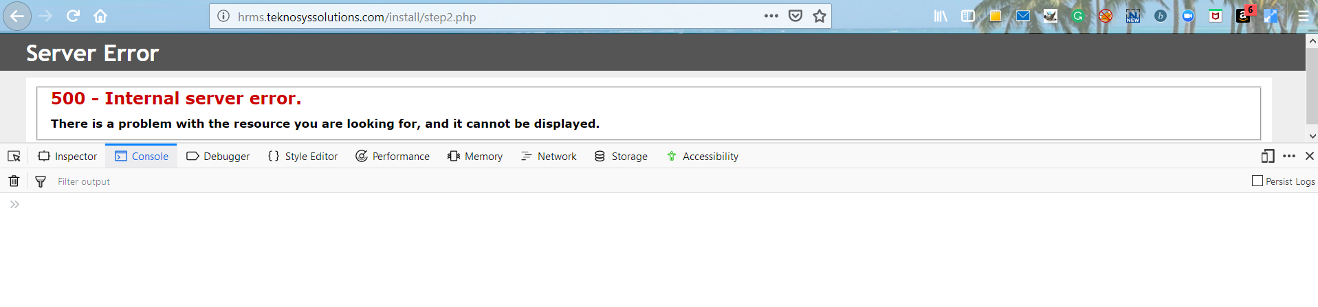

I checked the Inspect option for console and also for the network. The console is coming blank. The network page shows 500 error for step2.php. I have attached various screenshots for reference.
