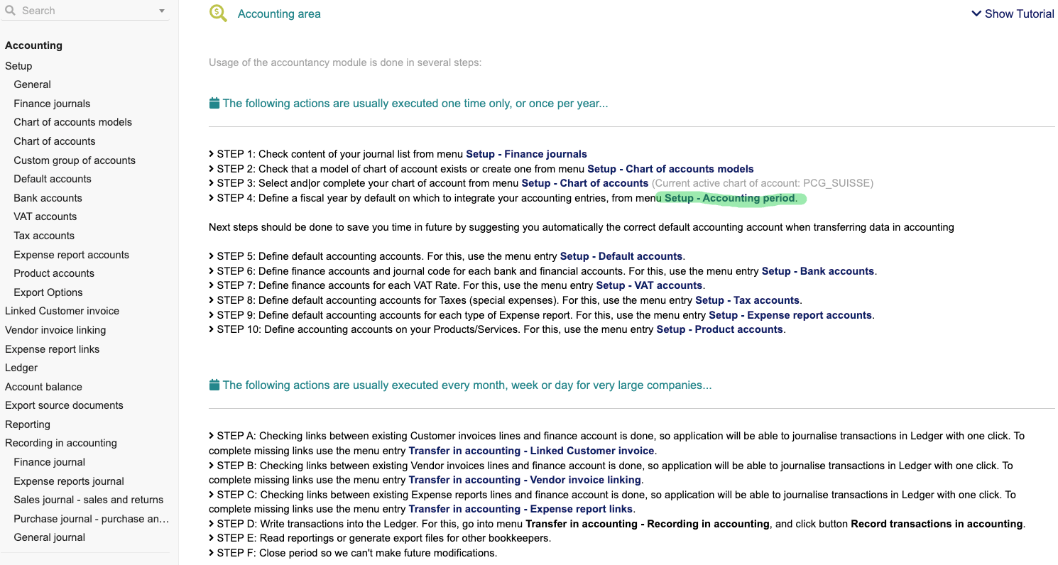

Many thanks for your comment. It guided me to where I could find the solution. In fact, looking at the normal accounting menu I couldn’t find the Accounting Period page.
However I then looked into the Accounting Tutorial page and found the link there which allowed me to insert the accounting period.
