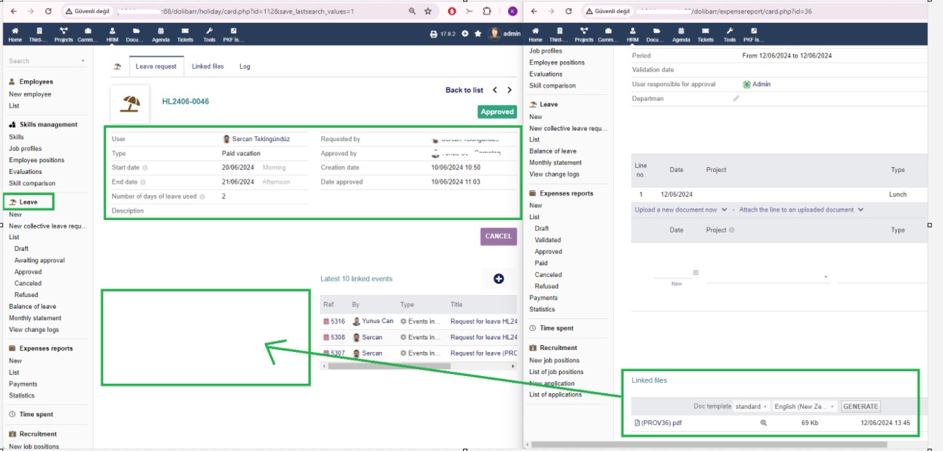

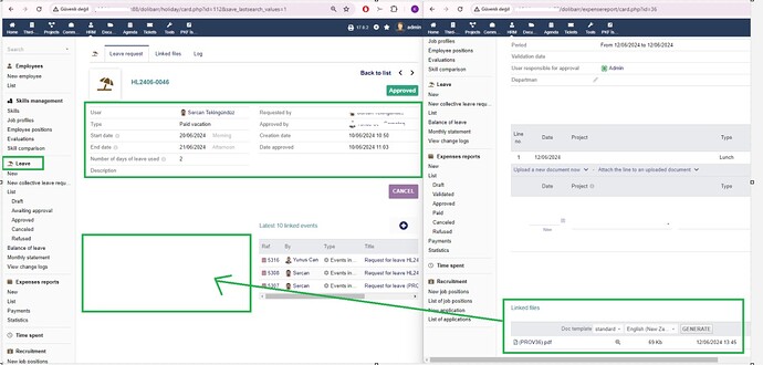

“I’m very new to using Dolibarr. I want to add the ‘Linked File’ feature shown in the image below to the permissions module. I want someone with permissions to be able to get a PDF output of this. How can I do this easily?”

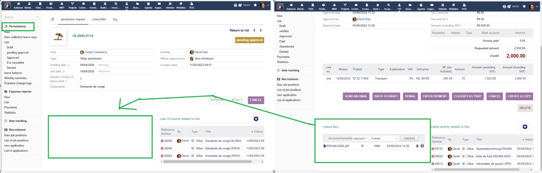

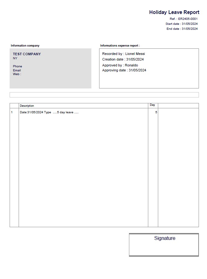

You want a PDF output that shows a list of all the linked files?
No, I think you want something else. I can not see the URLs of the page you want it added on, that would be nice to have too, because it reveals which file to edit.
aha, I see, makes more sense now. Don’t restrict it to only holiday leave, think of maternity leave too + possibly other kinds of leaves.
“Yes, I think so too. However, I don’t know how to do it.”

As for HOW to change the files and implement it. Look at what public functions are available in this file dolibarr/htdocs/holiday/class/holiday.class.php - which you then compare with other class files of dolibarr modules that does have the needed PDF functionality. You can - and should - copy a lot of the needed functionality from other dolibarr files to preserve the same look’n’feel as well as code style.
