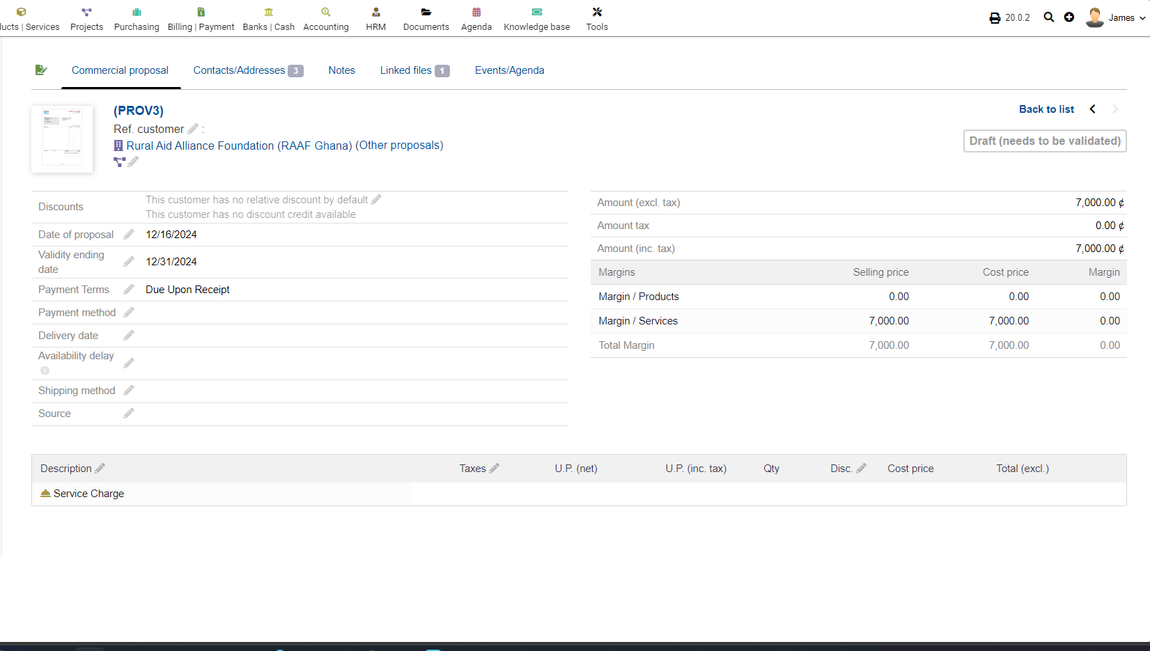

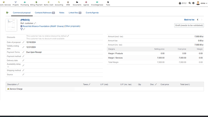

Unable to Continue Editing Proposal/Invoice After Adding First Line Item
I am currently experiencing an issue in Dolibarr where once I add the first line item to a proposal or invoice, I am unable to continue editing that document. Specifically, after saving or validating the first product/service line, any attempt to add additional lines or modify existing ones is simply not possible. Find attached screenshot.
Has anyone encountered a similar issue, and if so, how did you resolve it? Any guidance on troubleshooting this problem or pointers to relevant configuration/settings that might cause this would be greatly appreciated.

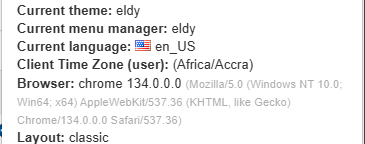

Which language code do you use ? (xx_XX)
I use php. (Xx_xX)
Yes but your language code ?
It must be something like xx_XX for example fr_FR for french language, or es_MX for mexican language. You can see the information in the popup on your user name once logged.
Oh you mean the default language? I am english speaking so I have defaulted to en_US.
