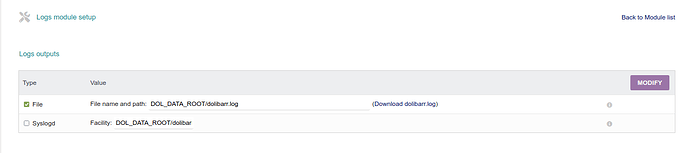

You can keep debug logging with PHP v8.1 with this configuration
The value you are using into field “Facility” is wrong. It can’t accept a path of a file. You must use for example “LOG_USER”

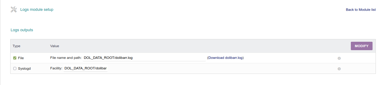

Hi @eldy,
“DOL_DATA_ROOT/dolibarr.log” is autofilled in field “Facility”
I’ ve confirmed it also by creating a clean 18.0.4 instance.
