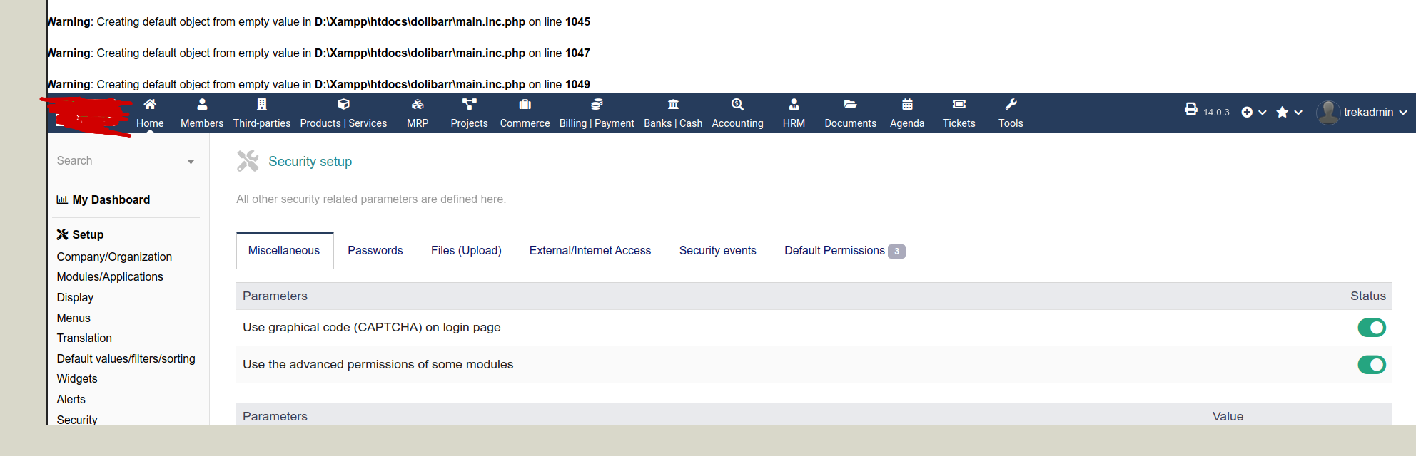

After i upgrade from 14.0.2 to 14.0.3 , it show warnings as below .

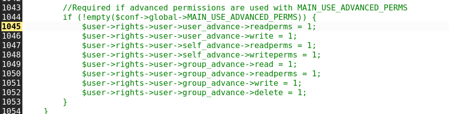

Then i check the main.inc.php , and this warning is about advance permission .
And after i turn off advance permission , the warnings are gone .
Are there anyone know how to fix it ?

My initial solution is to comment out all these which works but I don’t know the implication.
$user->rights->user->user_advance->readperms = 1;
$user->rights->user->user_advance->write = 1;
$user->rights->user->self_advance->readperms = 1;
$user->rights->user->self_advance->writeperms = 1;
$user->rights->user->group_advance->read = 1;
$user->rights->user->group_advance->readperms = 1;
$user->rights->user->group_advance->write = 1;
$user->rights->user->group_advance->delete = 1;
The FIX : Update main.inc.php by javieralapps4up · Pull Request #18772 · Dolibarr/dolibarr · GitHub
