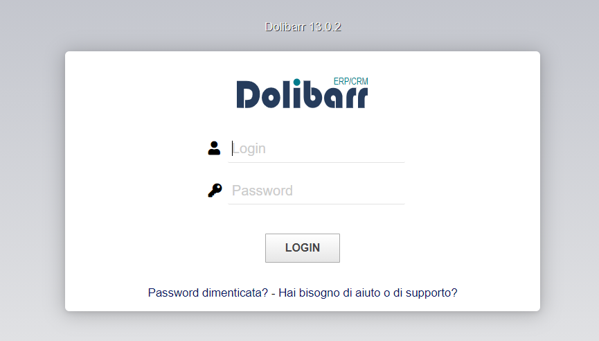

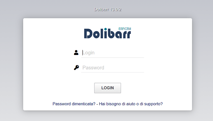

hi now I see this page, but I have not done anything, I had uploaded che htdocs/conf/conf.php file putting the new database name and table prefix, but without creating the database…
what have I to do to create the database? I see only this page now:
Remove the conf.php then you will be redirected to install
thanks now I see it, the wizard
