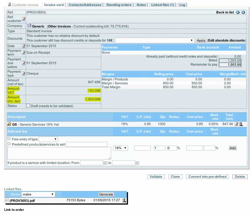

I have a same problem. Just upgraded from 3.2.4 to 3.6.3.
Am attaching screen shot. It seems the problem is with the calculation of the VAT and TOTAL part (highlighted in screen shot).
Unit price (inclusive of 18% VAT) of example is €1 therefore TOTAL should be €1000 and VAT should be €152.54.
Interestingly, the same does not happen when same quantity of same unit is done in POINT OF SALE.
I reattach screen shot cause original was difficult to read
Thanks to all
I solved the issue … solution was available here:
http://wiki.dolibarr.org/index.php/VAT_calculation_and_rounding_rules
Thank you
Another small update …
Although I had included “MAIN_ROUNDOFTOTAL_NOT_TOTALOFROUND=1” in OTHER SETUP the rounding up was still not 100% correct. The total still varied by a few cents although it was not as bad as without said entry.
After trying several things, I tried changing “MAIN_ROUNDOFTOTAL_NOT_TOTALOFROUND=2” and the TOTAL is now correct! I am unsure what I did exactly but it seems to be doing the trick.
